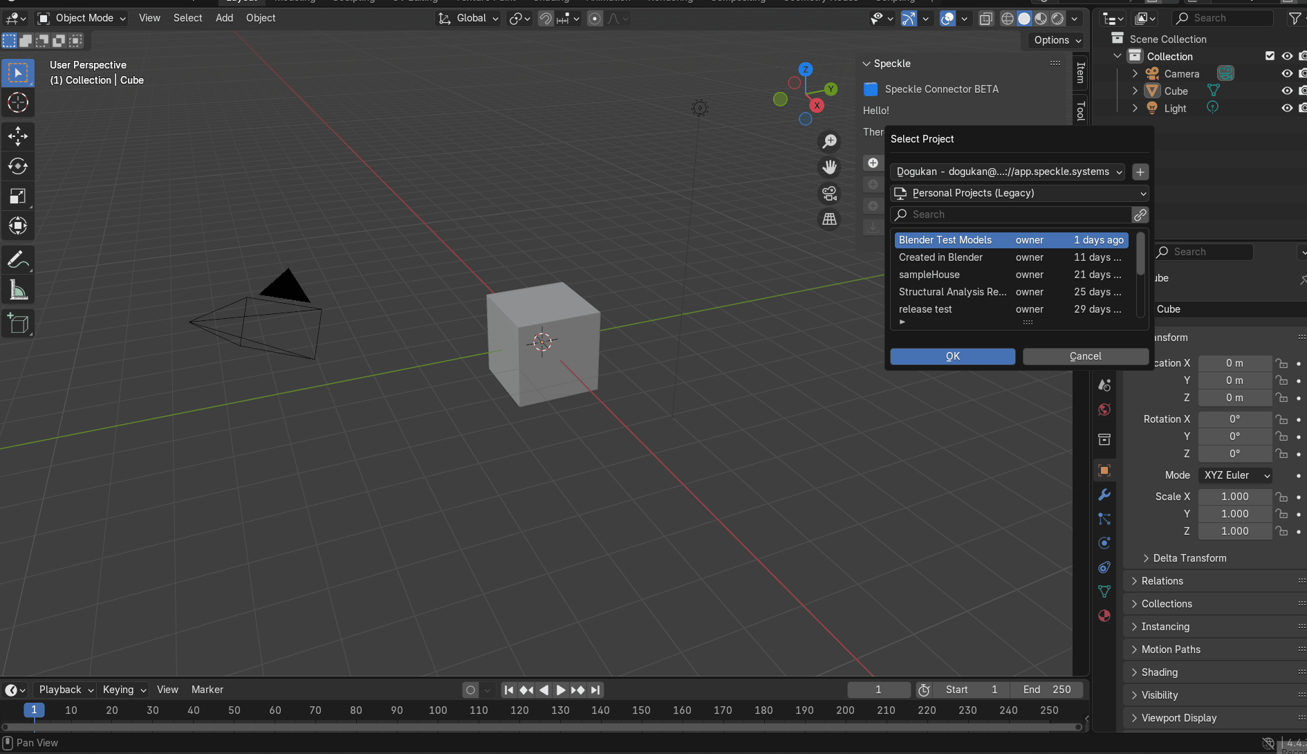

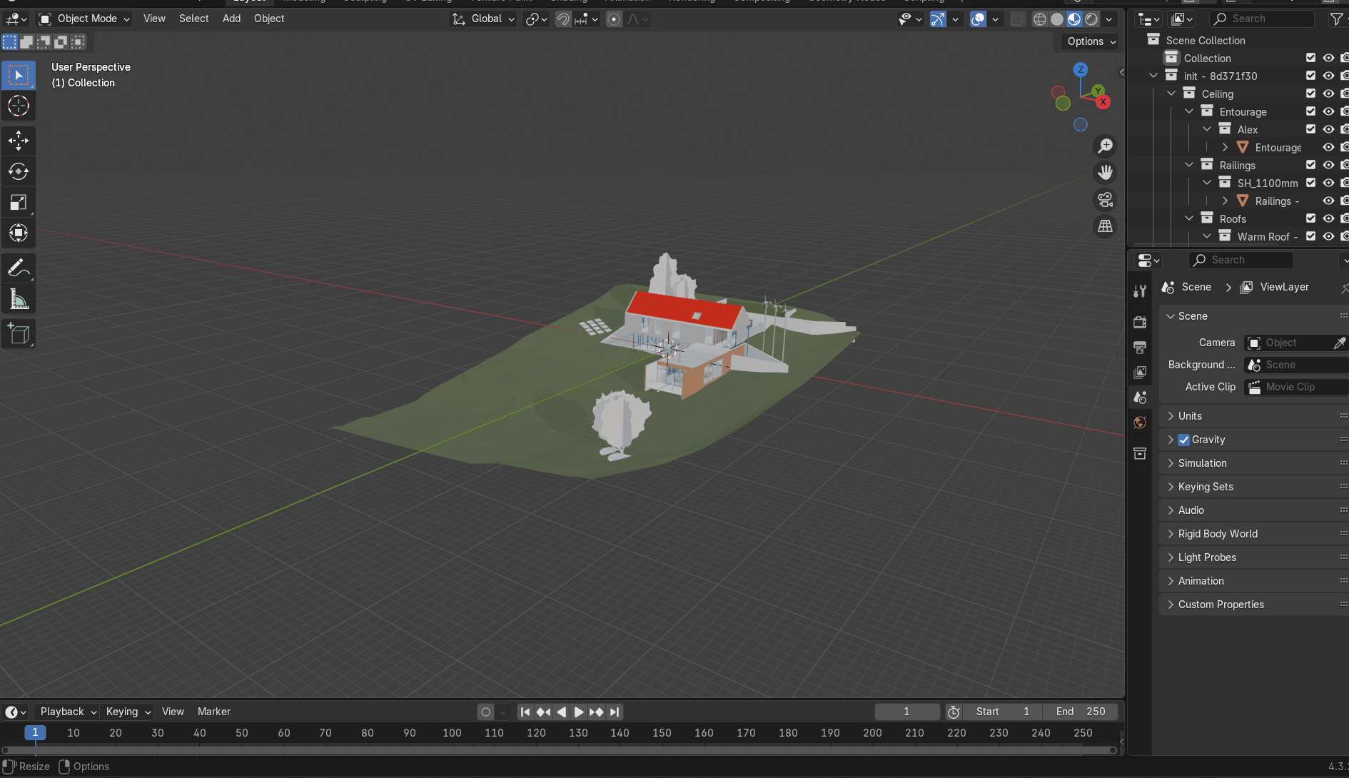

:loudspeaker: Next-Gen Blender Connector hits Beta! What’s cooking?
  • Integrated Auth Flow
    Now you can sign in or add new accounts directly inside Blender - streamlining your workflow.
  • Integration of Workspaces
    Navigate through your Workspaces easily with our integrated UI. Simple and efficient!
    workspaces
  • :brain: Magic Material Memory
    Our connector remembers your render materials. Update your model and previously assigned materials will automatically apply to the right objects.
    blenderMaterial
  • Conversion Upgrades
    We’ve improved our conversion logic with added support for vertex normals and instance proxies.
You can get it from Connectors | Speckle and give it a go. Your feedback shapes what’s next, looking forward to it.

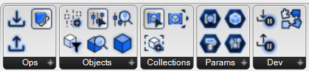

:cricket: Next-Gen Grasshopper Connector (Alpha) is ready for test runs after a couple months of hard work from myself, @dimitrie , @oguzhan , and our dearly departed @AlanRynne .
  • Install is bundled with the Rhino Connector: just update to 3.2.0.
  • Docs and Sample Files are included! They will be in Speckle Sample Files in your GH special components folder after install.
  • All new components created for data wrangling, design coordination, and presentation in the viewer - so take a look at those docs!

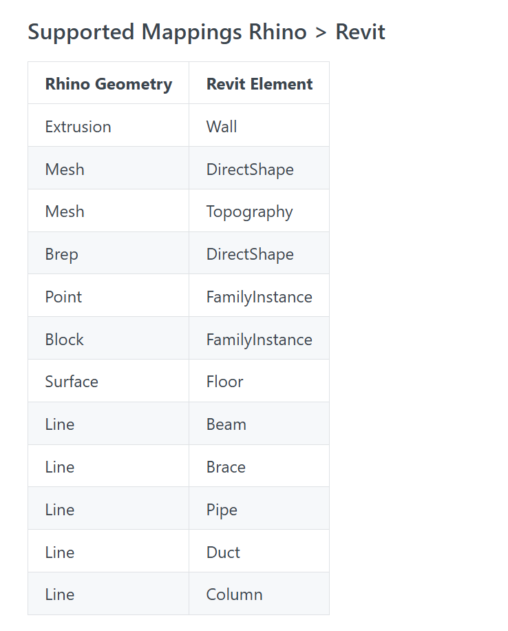

I second the above request on native elements for v3. For us the basic Wall, Floor, Column, Family Instance (via rhino block) would be amazing. And if im being greedy would love all of the below mappings yall had for v2 :wink:
