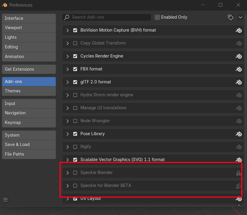

Hey @zoomer,
Did you try to activate the Add-on through Edit → Preferences?
Our installer currently has a limitation when it comes to Blender downloaded from the Microsoft Store, and we’re aware of this issue. Rest assured, we have a ticket open to address it!
Yes, I did try to activate it in Settings and it is not successful and causes these warnings.
I think usually when you install a standard AddOn in Blender, it is already activated by default.
(May be different if you load them as an “Extension” version, AFAIR then you have to switch back to AddOns Tab and activate it manually. Like BlenderBIM/Bonsai)
That does also work on Windows for v3 with its external Installer exe - the AddOn is already activated when you start Blender.
At least for the first time. AFAIR, if you deactivate it (as you do not find Speckle in Blender GUI) I was not able to reactivate it again. AFAIR it also failed for later installation attempts.
v3 installation for me worked only 2 times. Both time I had booted Windows before.
I think the same should be on MacOS.

Hmmh, I really don’t get it.
There came a V3 Beta 2.
I installed it on Blender 4.4.3 official on Windows - it does install the v3 bpy_speckle Folder - it is activated - fine - but still no Speckle Tab in N-Panel.
I also copied the bpy_speckle Folder on my Blender Mac installations. Available in AddOn Menu, still not able to activate (Pydantic warning)

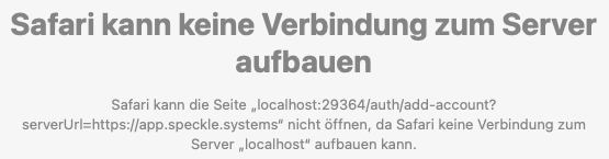

Nevertheless v3 in Blender asks for an Account,
opens a Safari Window to :
http://localhost:29364/auth/add-account?serverUrl=https://app.speckle.systems
which does not work :

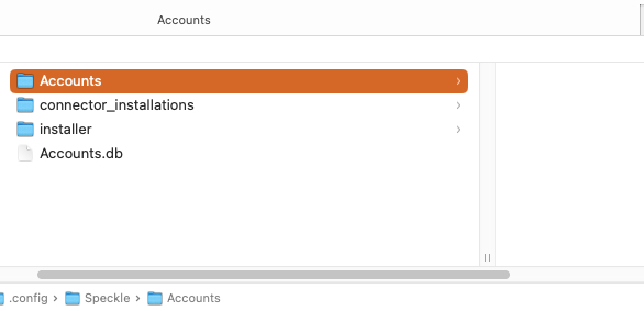

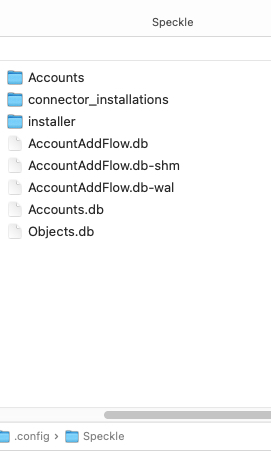

But I am not sure where it stores it.
From v2 times I was used that there was a hidden .config folder directly in my user account. Likely Manager App stores it here.
Although the Account folder is empty, there is an Accounts.db.
(EDIT : I copied it over from there (next Screenshot) … did not work )
But it looks like v3 uses a different folder.

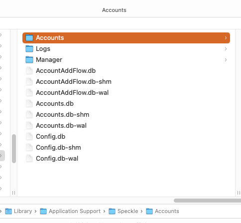

AFAIK the Speckle Folder in User/Library/Application Support/ is new and came with v3 ? It also has an empty Account Folder but Account DBs.
EDIT :
No, looks like this exactly the Place where v2 Manager saves its Accounts.
As you brought me to the idea, I copied the whole Accounts DB stuff over to my hidden .config Folder in my User Folder.
And Tada !
That works - I’m in now.
Looks like Blender Speckle v3 also works on Mac.

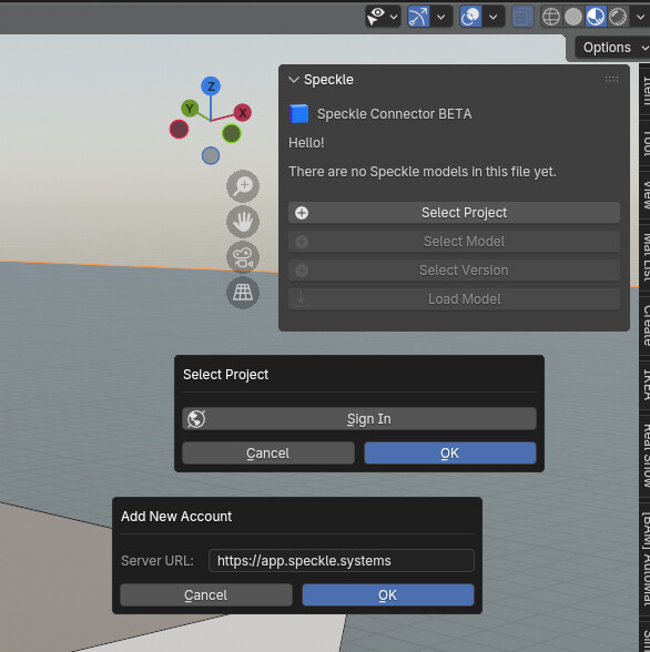

for the online auth I also tried to input my whole Speckle Workspace Project Path.
Which also failed.
But as I recognize in my own Screenshot, the Dialog following to the “Sign In” button says : “Add New Account” !?
So far I thought, this localhost procedure would take me to the usual Speckle website sign-in process … to then save these (now trusted) credentials locally on my Mac for v3. …

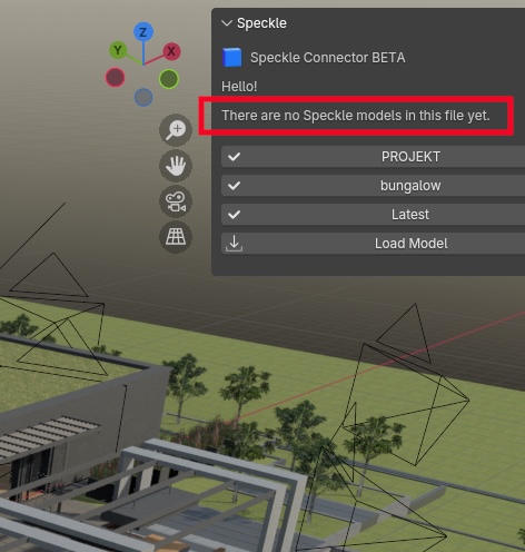

But now something else …

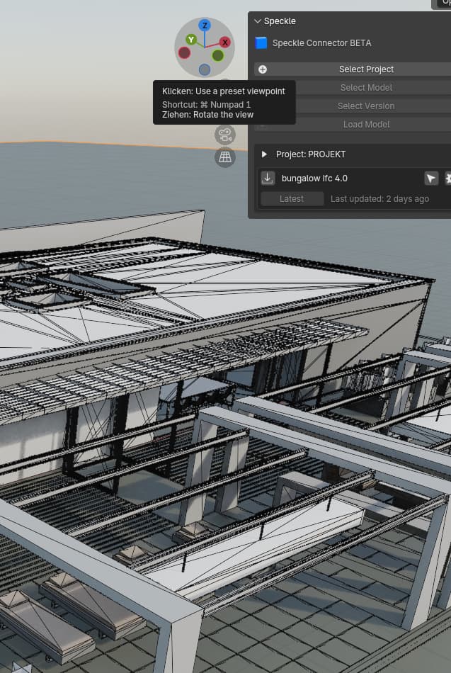

As, since deactivating Bonsai, now have running Speckle Blender V3 fine on Mac.
(Successfully down loaded a few of my test projects into Blender)
But I do not find how to upload a Blender model up to Speckle !
(Would like to see new V3 features of what is v3 capable of loading up to Speckle. Materials, Hierarchies, Data, … )
I can’t see any option for upstreaming, in the new reduced Speckle Panel UI.
Or is that just not yet implemented in Blender Connector V3 Beta 2 ?
… I know … it is a true Blender scene (or better an enhanced former FBX Import)
But i want upstream that file, from my first working Speckle V3 Beta Connector, to test how lossless or not it comes in to Speckle and streams back into Blender … :slight_smile:
Sorry, also not true.
