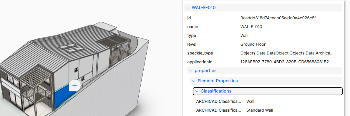

  • for Archicad, classification info is now inside Properties (one element can have many classifications, which was a limitation of the old schema)
  • all application DataObjects will have their type on the object, in the type property (not speckle_type)
