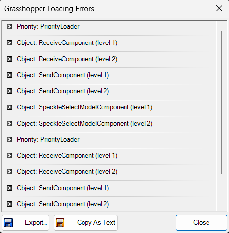

Grasshopper - Component ID Conflict Error

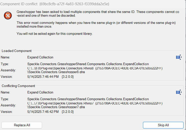

I have Rh7 and Rh8 installed, and when opening Rh8 I get component ID-confict error message about duplicate components for both versions.
and a list of Grasshoper loading errors.
Grasshopper Loading Errors
Priority: PriorityLoader
Menetelmää ei löydy: System.IDisposable Speckle.Connectors.Common.Connector.Initialize(Microsoft.Extensions.DependencyInjection.IServiceCollection, Speckle.Sdk.Application, Speckle.Connectors.Common.HostAppVersion).
MissingMethodException
Object: ReceiveComponent (level 1)
Kutsun kohde on aiheuttanut poikkeuksen.
TargetInvocationException
Object: ReceiveComponent (level 2)
Arvo ei voi olla tyhjäarvo.
Parametrin nimi: provider
ArgumentNullException
Object: SendComponent (level 1)
Object: SendComponent (level 2)
Object: SpeckleSelectModelComponent (level 1)
Object: SpeckleSelectModelComponent (level 2)
Even when I rename Rh7 plugin .gha to eg. .ghabak to prevent loading. The conflict error gets resolved, but I still get a bunch of loading error.
Rh8 SR19, Win11

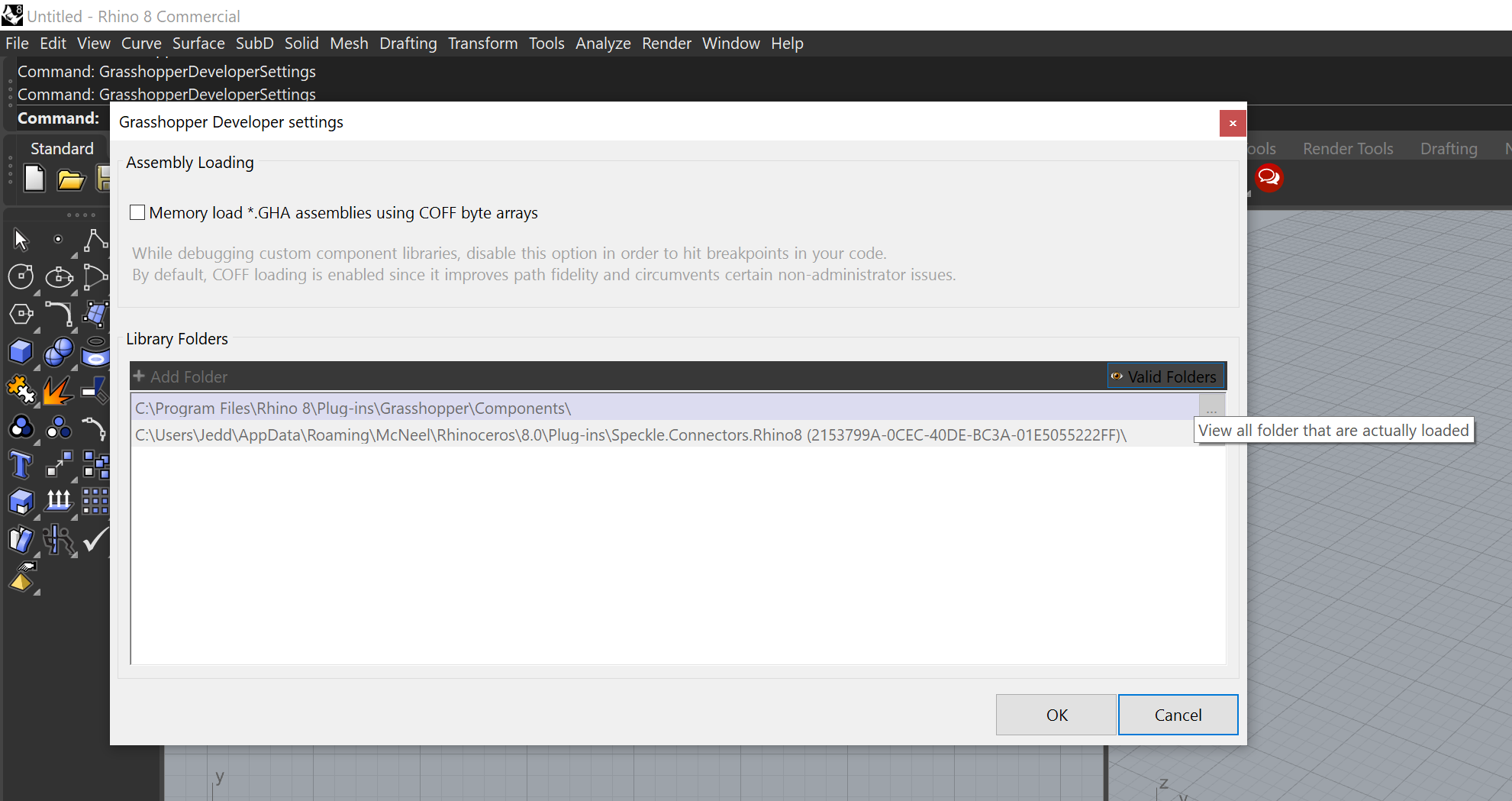

Please could you execute GrasshopperDeveloperSettings (it’s a rhino command)
And then click the 👁 Valid Folders button to see all loaded folders.
Should look something like this
Please could you send me a screenshot of what you see?

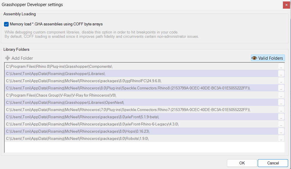

@Jedd
Here.
Ok… I think we’re getting a little closer to solving the mystery then…
The line here that references Speckle.Connectors.Rhino7 should not be here…

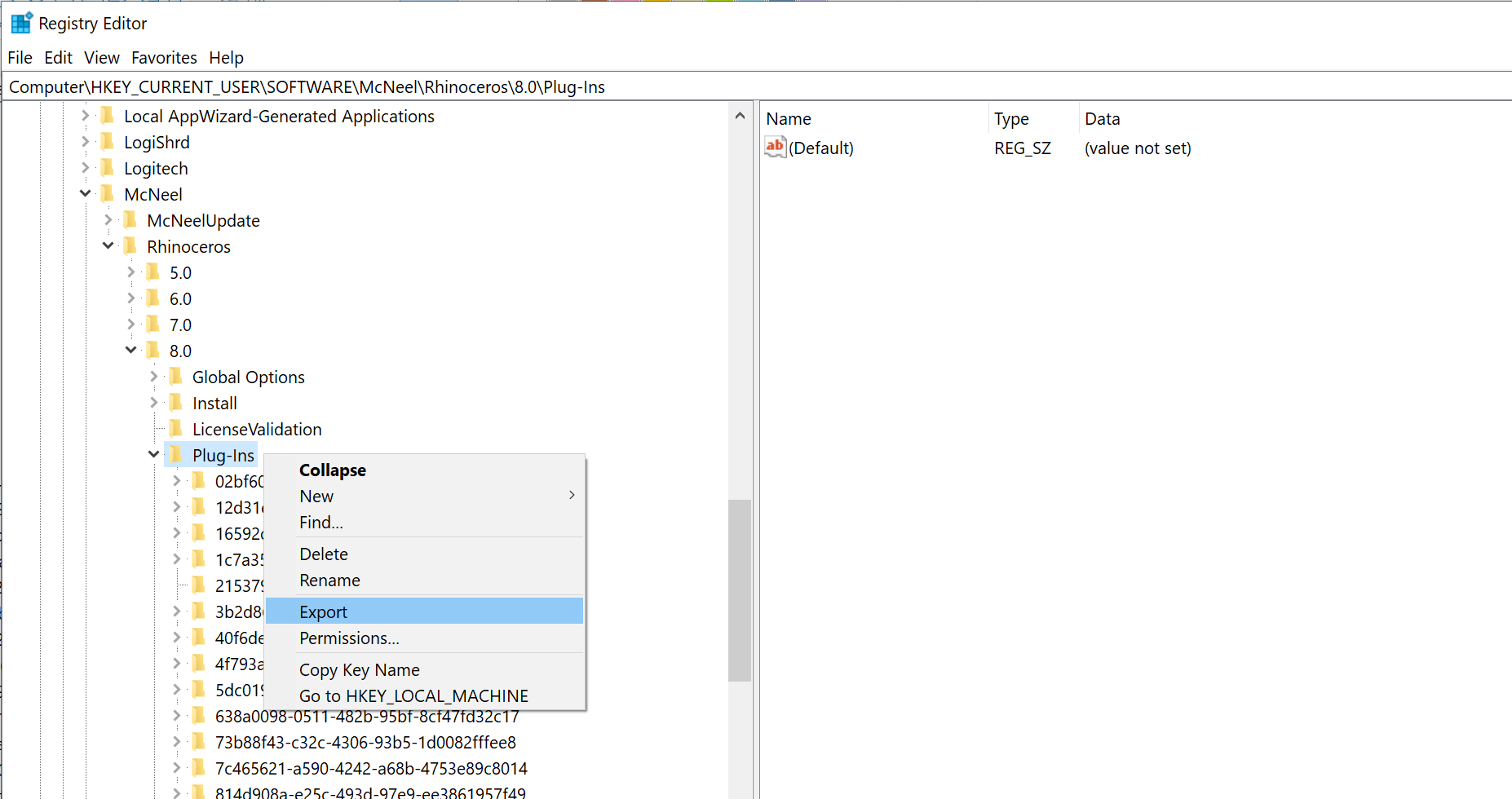

Please could you follow these steps:
  1. Open the Registery editor by pressing Windows key + R to open the Run menu, type regedit.exe and press enter.
  2. From the left panel, navigate to HKEY_CURRENT_USER\SOFTWARE\McNeel\Rhinoceros\8.0\Plug-Ins
  3. Right click on the Plug-Ins folder, and click Export, like so:
  4. Save the .reg file somewhere.
    I don’t think the file will contain anything that would be unsafe to post publicly here, but lets play safe, send this to me as a direct message.

  7. Restart Rhino8 - no conflict error, but get Grashopper loading errors:
Grasshopper loading errors

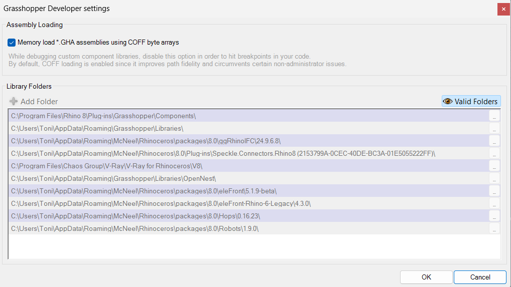

And what does your GrasshopperDeveloperSettings look like now?
@Jedd
As such.
Hmm… well it’s progress that rhino7 is no longer appearing in your GrasshopperDeveloperSettings…

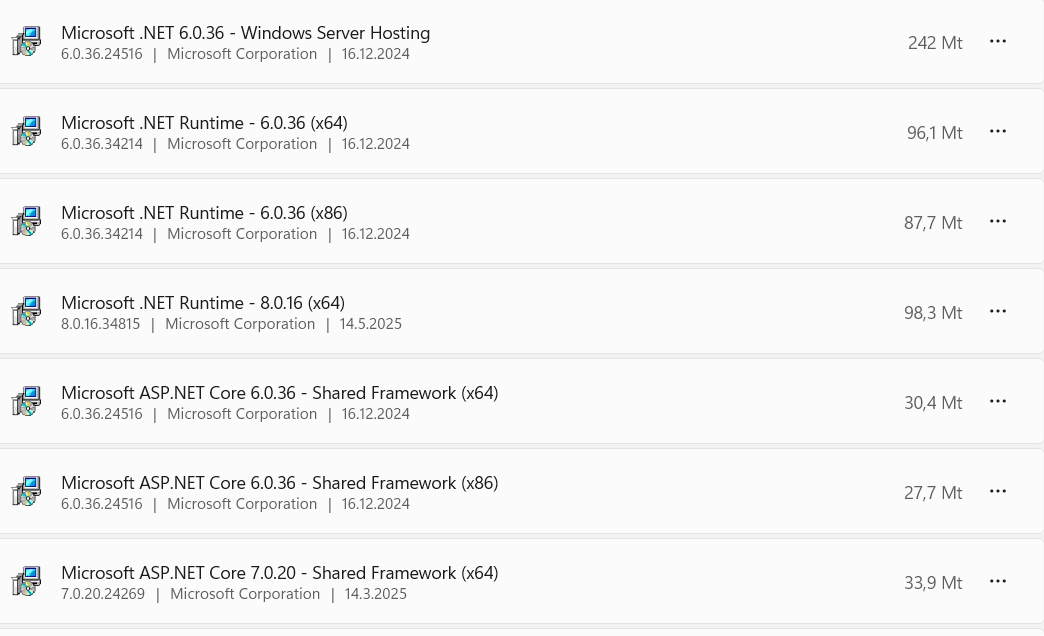

Is this dependent on some .NET version, etc… I really don’t know anything about those, but I just had to install one particular ASP.NET version, in order to get Hops working.
