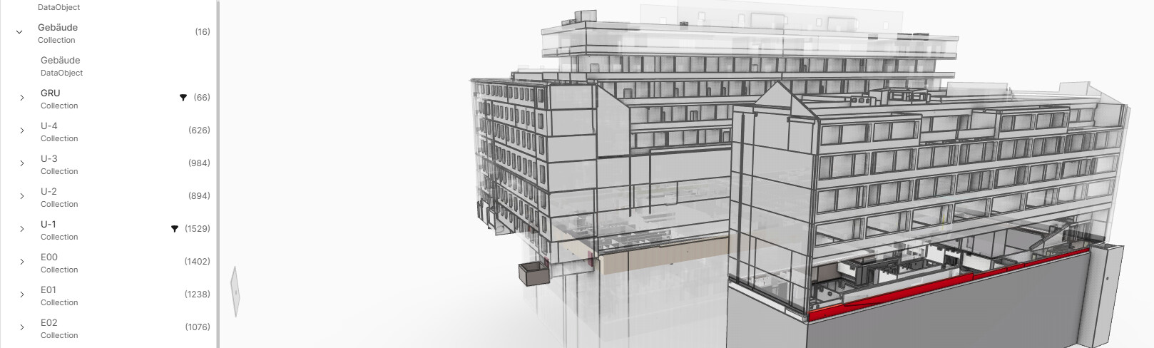

Hello guys,
when working with the Speckle Viewer and isolating objects in a bigger scale, hiding complete storeys. The ghosted hidden elements are still visible due to overlaying multiple transparent objects(a hunch).
It would be beneficial the hide the objects completely. Some viewers like BIMcollab offer a mode transparency and a mode hide. This leads to more control for people navigating through a building.
Transparency was a wish I had already in the past. It helps everyone who works with your viewer for design work.
Best,
Alex
We recently added the toggle for “Ghost Mode” in PowerBI. Have you tried this? Is that the behaviour you are looking for?
Yes tried it out and this is the bevaviour I’m looking for
