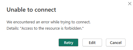

I went to PowerBI, get data, search speckle, paste the url of the model that i uploaded in the account that uses the same e-mail as PowerBI, but this sign pops up
I would apreciate the help, i have all the connectors updated

Hey @NicolasRivero
It has to do with PBI and how it stores credentials, can you please try the following:
Let us know if it works.
Thanks! @Nikos & @teocomi
I’ll read the post and try if this works
I appreciate your time
Hi @teocomi , the last post was really helpfull,
I cleared the permissions and now i can get data from the link

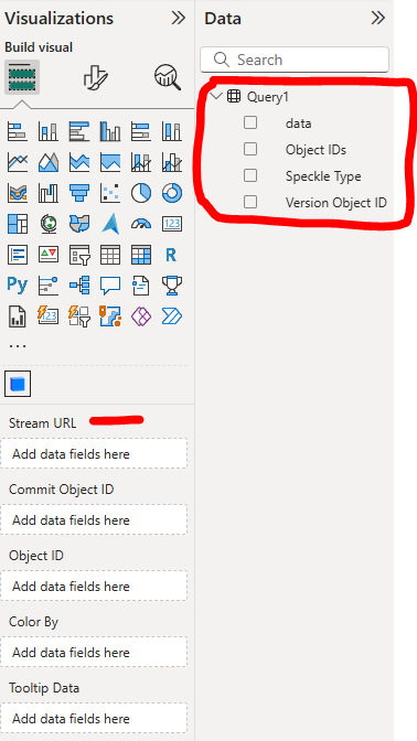

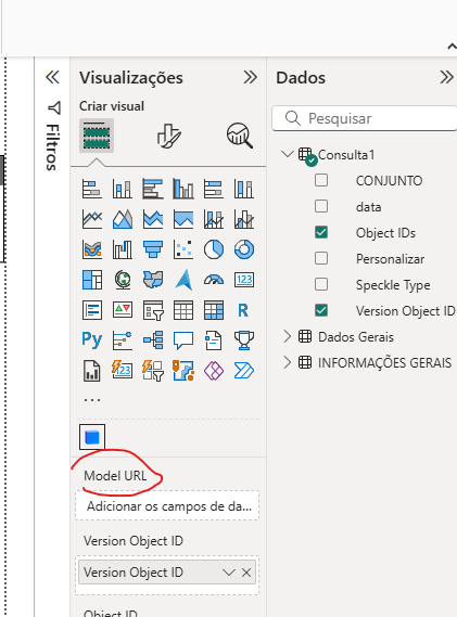

When i get the data from the speckle link, some of the data that the speckle/powerbi viewer need does not appear.
I’m attaching a picture of the data i get, and the data the viewer needs.
What am i doing wrong?
Thank you

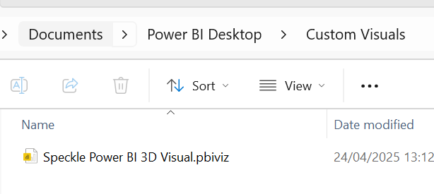

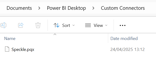

@NicolasRivero You have a New Data Connector but a reasonably old and out-of-date Visual.
Whereever the visual is installed from you’ll want to delete that file and just use the latest one we have.
If you are using the latest installers, this will install both data connector and 3d-visual
on my machine
The visual you can install from file and find it at that address
Thank you so much!
It works perfectly fine now

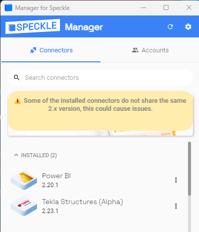

Hi @jonathon,
I am having the same problem.

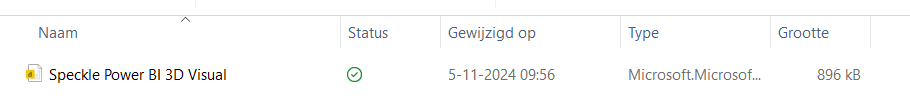

I de-installed the plugin and installed the latest version with the package manager.
The latest installed visual however has an older date than the one shown above.
When trying to import the data I get the same message:
@Erik_Beeren try installing from https://app.speckle.systems/connectors
@jonathon
Unfortunately still no luck.
Do I have to regenerate the model with the new connectors?
