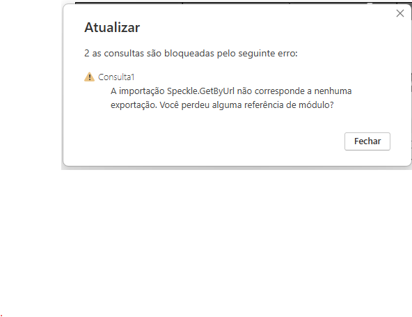

I installed the connector 3.0 and clean up the permissions like answered before the problem continue happening.

If I delete and try to update, that error appears.

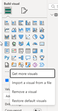

Data connector queries looks correct, they are v3.0.0, but your visual in the file is old one. Well, you are trying to use new data connector with old visual. Could you try to remove the visual and import again from the menu below?

I removed and before installed again but nothing change.
Hey @Planejamento_Inusa ,
If you check the readme of that repo, you can see that it’s the legacy visual repo. Latest 3D Visual is bundled with Power BI connector and installed under Documents/Power BI Desktop/Custom Visuals. Please remove the currently added visual and add the one that’s under this path.
