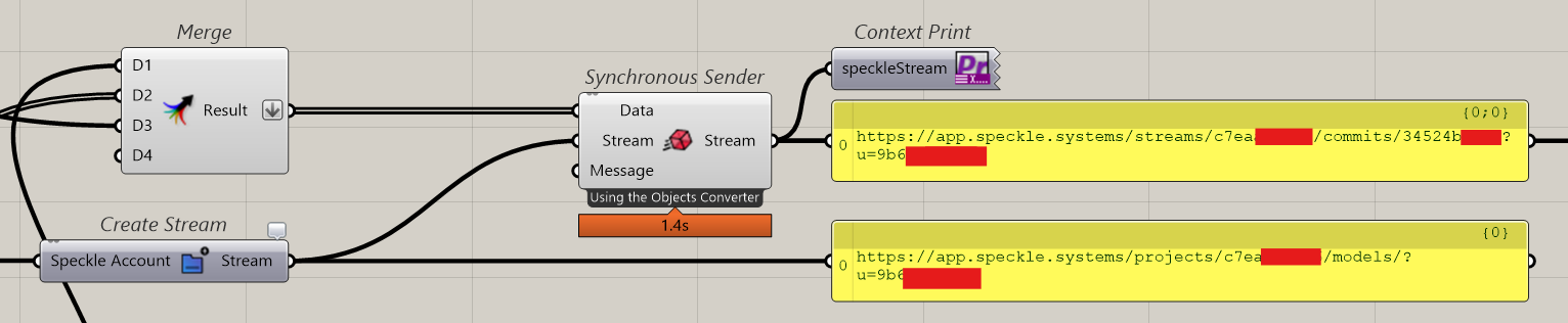

To get into more details, for the two URLS shown in the screenshot, when i open them in the browser:
  • The first one redirects me to the right model page, but doesnt get past the UrlHelper.getResourceUrls
  • The second one only takes me to the project, not the model. It seems to be missing an argument.

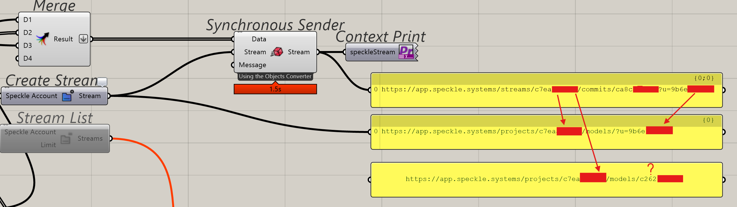

Hi again @jonathon and thanks for the feedback.
Thing is, as you see above i have 3 URL:
  • First url coming from Synchronous Sender component
  • Second coming from Create Stream Component

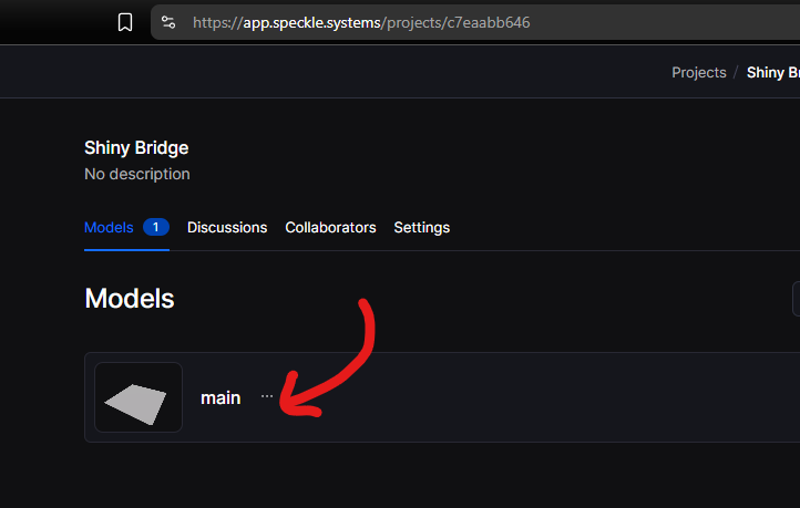

  • Third one coming from Copy pasting the second one in the browser then clicking on the first model
I don’t see how i can parse the modelId, even with text manipulation which would not be an issue, since it’s nowhere to be found in either one of the two URLs.
