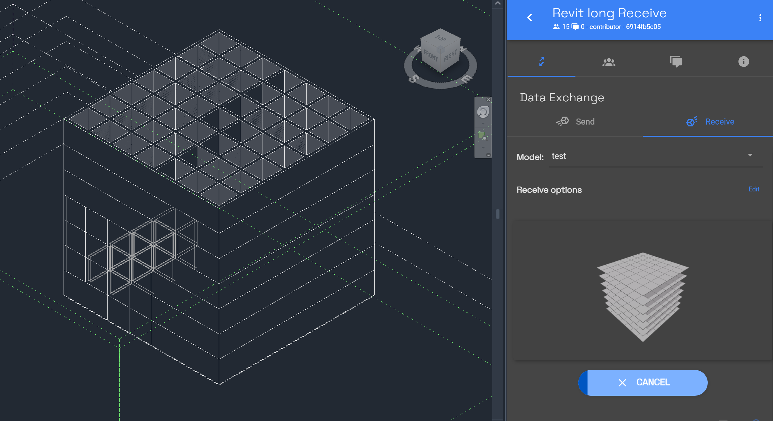

Everything is in the title: the Receive part of Revit Connector takes quite long: see example below.
Revit_KUhqQehT3f
Am I missing something?

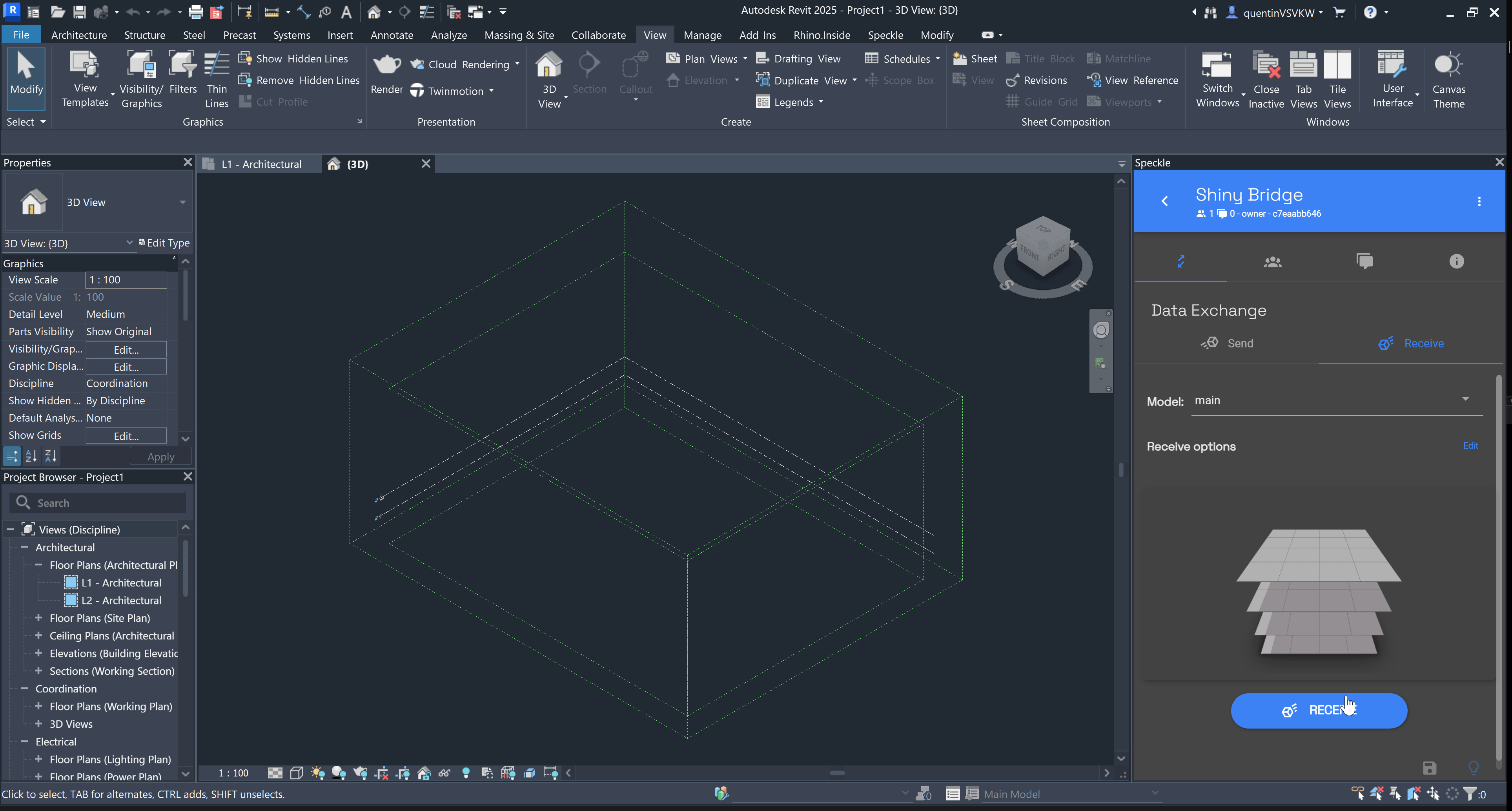

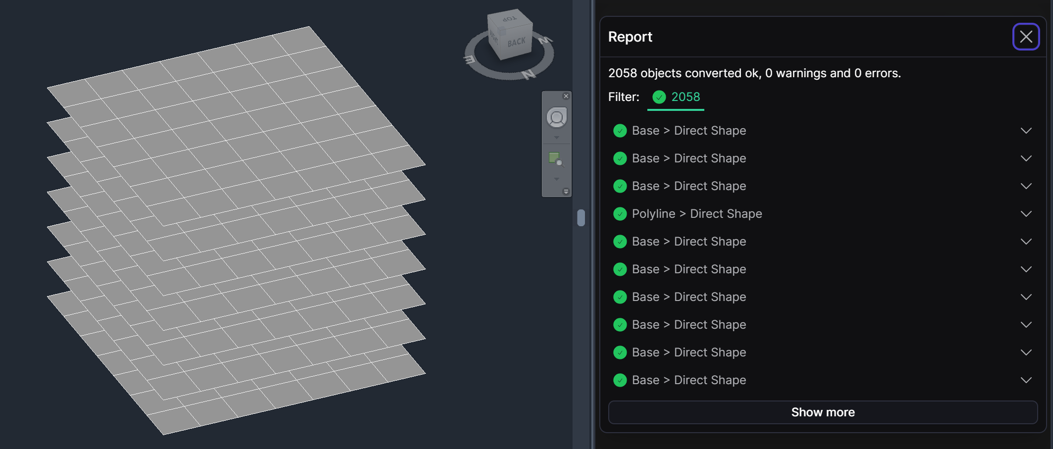

Weird, are you opening it in Revit 2025 as well? Also i see it didn’t seem to load the walls , which should be here (dont mind the fact it’s not full, the loading was still ongoing)…
It does take very long on my side, several minutes.

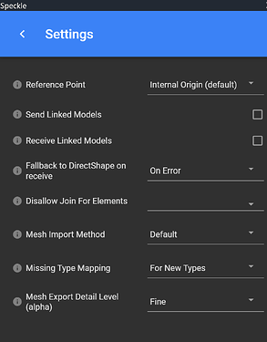

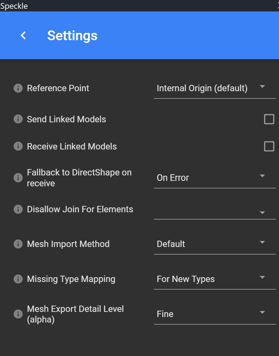

Here are my settings (i left the default ones)
Is there anything else you need to know?
Ah, I got it - there are BIM Schema objects from Grasshopper, and using v2, I received it at total face value.

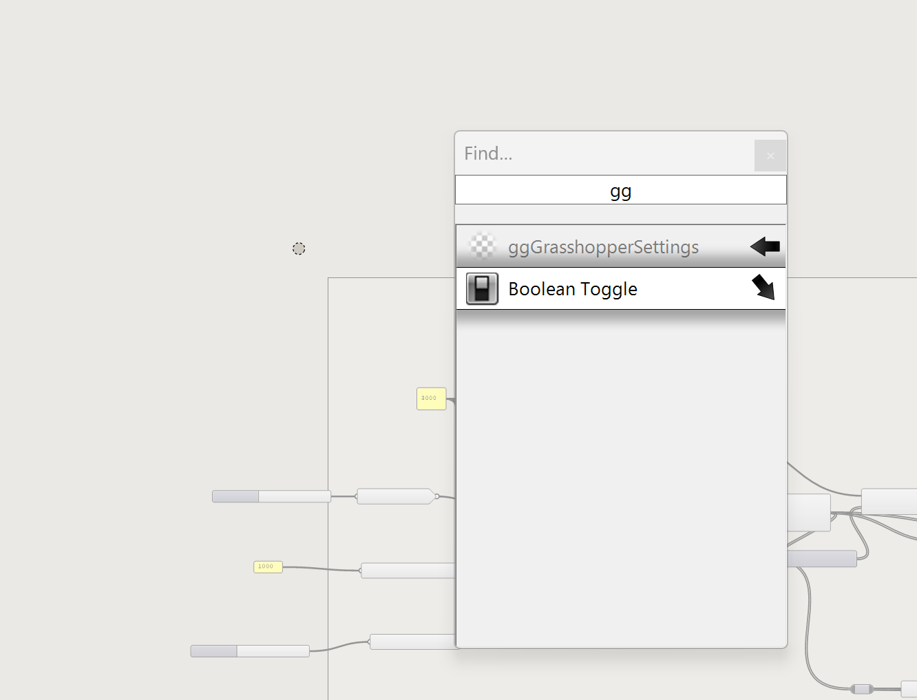

Just so you know, in the first GH file i had a remaining GeometryGym component that is impossible to delete.
I created a new GH file copy pasted all components but the GG one, created a new model in the same project and sent a stream to this model. The loading time is equally long in Revit so component from GG doesn’t seem to have any impact :thinking:
What do you have in mind in mentioning this?
