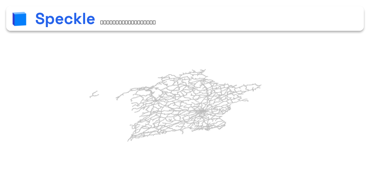

I actually tried to send data into speckle.
This is a shp file from SNCF open data available here
I created a stream via the browser, selected it, sent it. but it says “no displayable objects found in object xxxx”
The data view doesn’t show anything
Stream ID : fb7352fbd9
Any clue… ?
Hmmm… silly question, but could it be that you didn’t select any layer to send on the SpeckleQGIS panel?
PS: we desperately need to upgrade the UI, it’s on our todo’s already :slight_smile:
I guess I did :confused:
It will allow you to press send without a layer selected. The layers list shows the available layers. It isn’t clear but you do need to select them in the list.
@jonathon beat me to it!
Screenshot 2022-07-06 at 13.28.25
aha! wohooo
thank you both!
