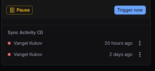

Same issue, NWDs time out after 1200 seconds, kindly advise
Apologies, forgot to mention the project files are synced from ACC
Hey @Vangel_Kukov ,
Can you share the Speckle model url? You can send a DM if you don’t want to share it publicly.
I cannot share itas it is a confidential project. The project is synced with ACC, RVTs that fail to sync up to 1GB, NWDs that failt o sync up to 4GB.

I don’t think the sync is failing, it just takes longer than 20 mins to complete. If there’s an option to remove the time limit, it should sync @gokermu @jonathon
