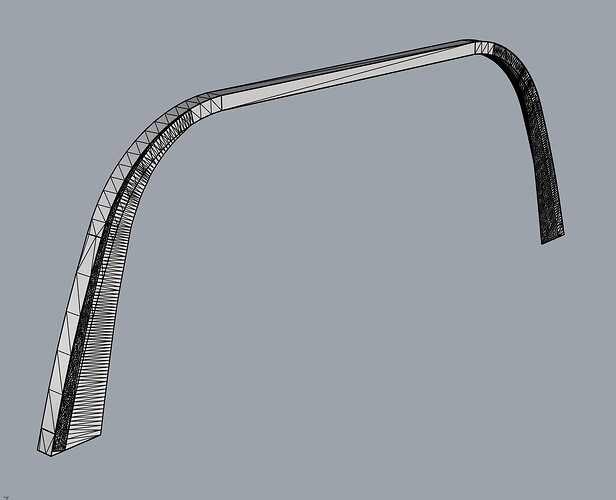

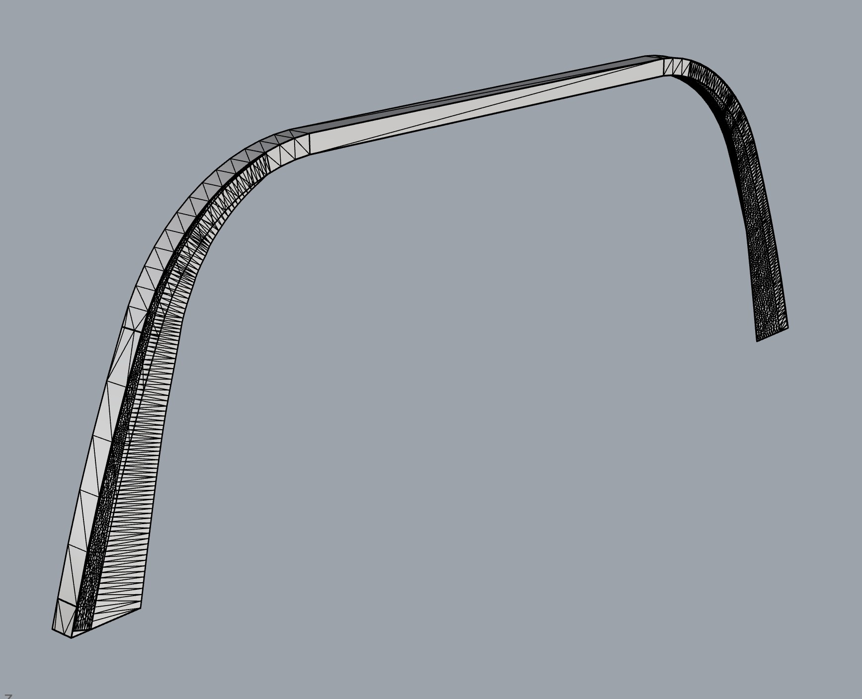

Solids are needed as reference geometry, especially with curves, meshes are not suitable. I believe it used to be that Speckle used solids before, not sure why the option was removed.
@gokermu even when I am exporting small portions of a model to Rhino3D for design work it comes as meshes, is there a workaround, cheers
Revit to Rhino workflow never supported breps. There is no workaround (within Speckle) at the moment.
