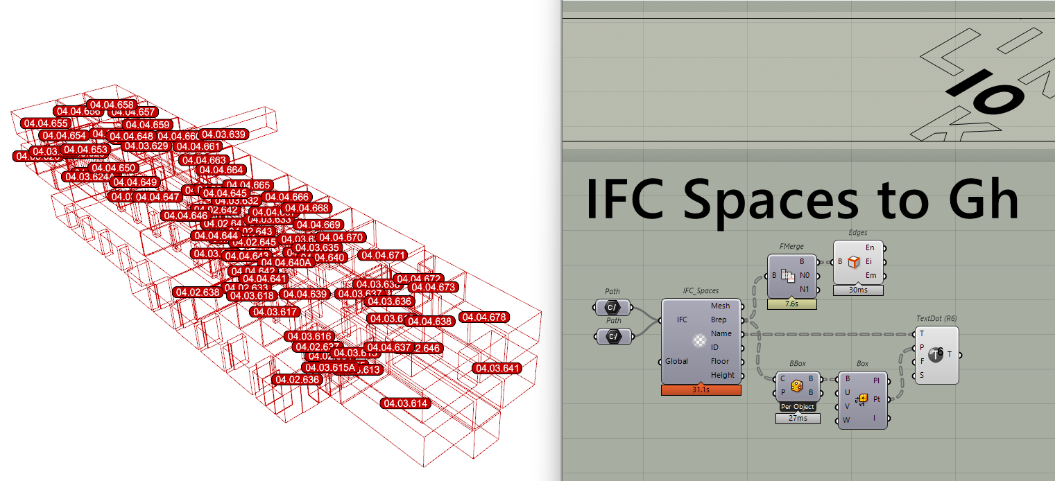

While not perfect, here’s a GIST on how to do it with Grasshopper and XBim.
You’ll need to create a grasshopper plugin in visual studio, add XBim 6 to NuGet and use the attached code.
I’m hoping this can help the speckle team on reading IFC Spaces (its a start, not perfect)
