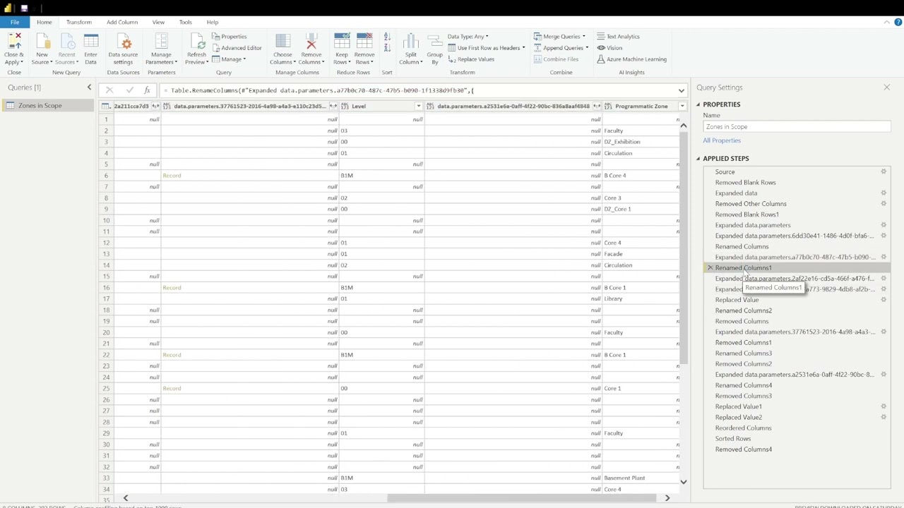

An alternative to the full parameter path is to prepare the speckle stream data with with Power Query prior to visualisation.
From there it may be a case of expanding the columns listed as containing records and selecting which values to show and hide. Quite a lot of the Speckle object info can be discarded from a data analytics point of view - its data that makes Speckle tick in all the connectors, not for us humans.
Short and boring video just showing that.
@jonathon thanks yes this is even better, and for the real name on revit maybe we can add the Parameters.The Parameter.name this way we can knew the real name of the parameter if we want to use it for selection, and i tried another way for the shared parameters or parameters that changes on speckle i just used an excel exported from Revit with Those parameters and linked them using The elementid :+1:
