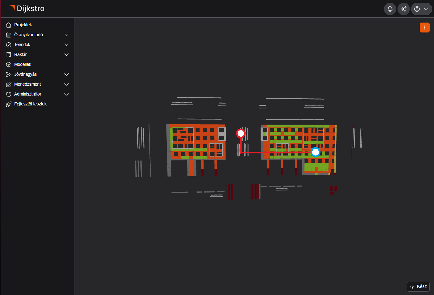

Hello everyone,
I have encountered an issue where the rotation and zoom center of my loaded viewer is offset.
In the attached image, the red circle represents the cursor position, while the blue one represents the origin.
The amount of offset matches the values of the header and the side menu.
Is it possible to manually adjust the origin position?
Thank you in advance for your help!

From what I see in your video, it seems you’re having issues with the orbiting around cursor feature which is turned on by default.
We’ve added orbiting around cursor relatively recently. Since it’s giving you trouble, I suggest you just turn the feature off
const controller = viewer.createExtension(CameraController);
controller.options = {
  orbitAroundCursor: false,
  showOrbitPoint: false
Orbiting around cursor properly works only when you’re dealing with meshes. Lines and points are not supported yet. I can’t tell what your scene consists of just by looking at it, but there are things resembling lines in there. So the easy solution is just to turn off the feature like I show above
Cheers
Thank you!
This solved the problem.
