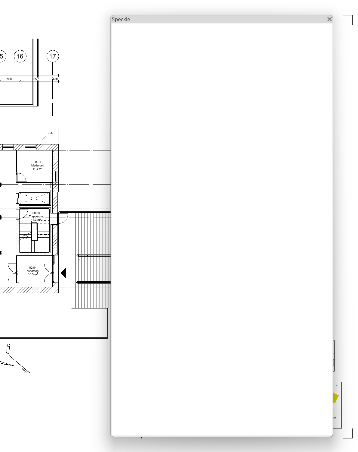

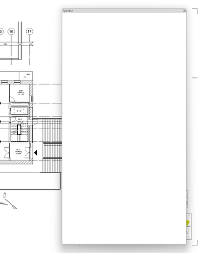

A similar issue here.
Revit 2026 on a Windows 11 machine.
Speckle Connectoren version V.3.10.0.
Speckle Server running 2.26.3
Unsuccessfully followed both of these:
