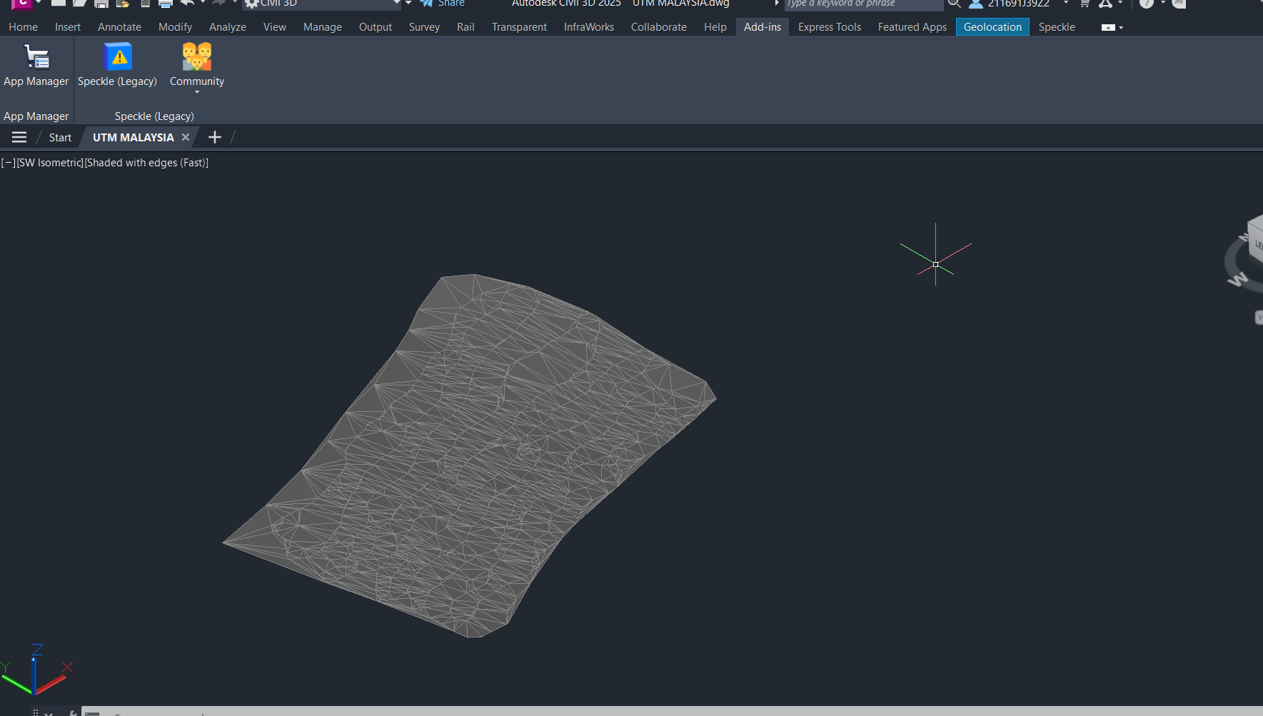

Hello everyone,
I’m trying to download and install the Next-Gen Speckle Connector for Civil3D, but after running the installer, it still appears as “Speckle (legacy)” in the toolbar. I need the Next-Gen version to work today, as my deadline is very close.
I suspect from your image that you have the v2 (legacy) installed, but not the v3
Did you install from https://app.speckle.systems/connectors? We are no longer using Manager as an installation path.
