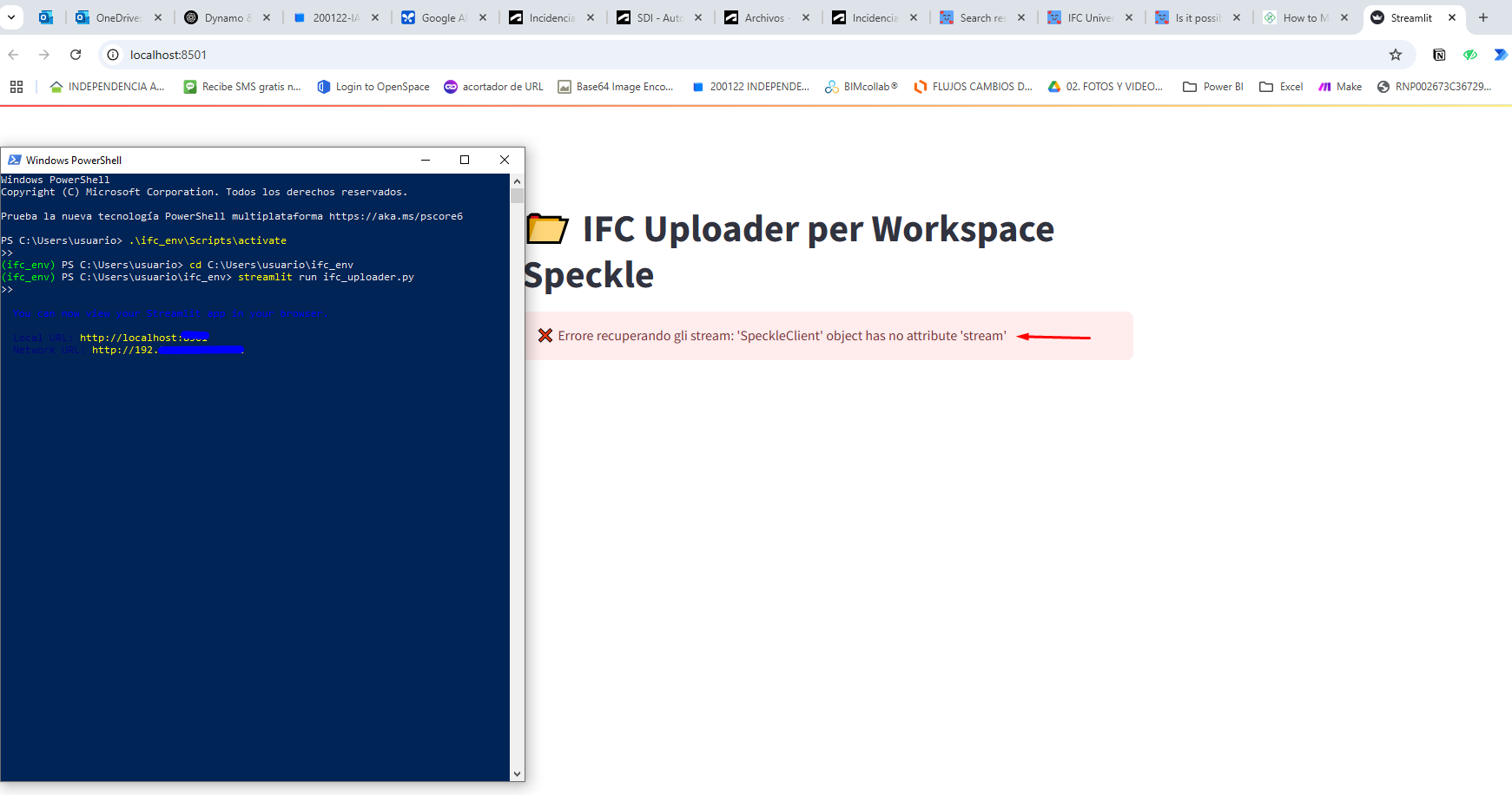

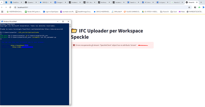

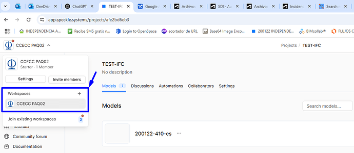

Hi everyone I was looking for automation options to upload files in bulk in the Speckle environment and I came across this post about IFC Universal connector - for workspaces . @oscarazzus It really caught my attention, I was trying to use it but every time I use it I get this warning [Image 1].
As you can see I have that warning on the web.
The steps I performed were the same as in the post.
I have the current Starter plan.
I don’t know if I have to modify anything else that I am not contemplating.
Thank you in advance for your response.

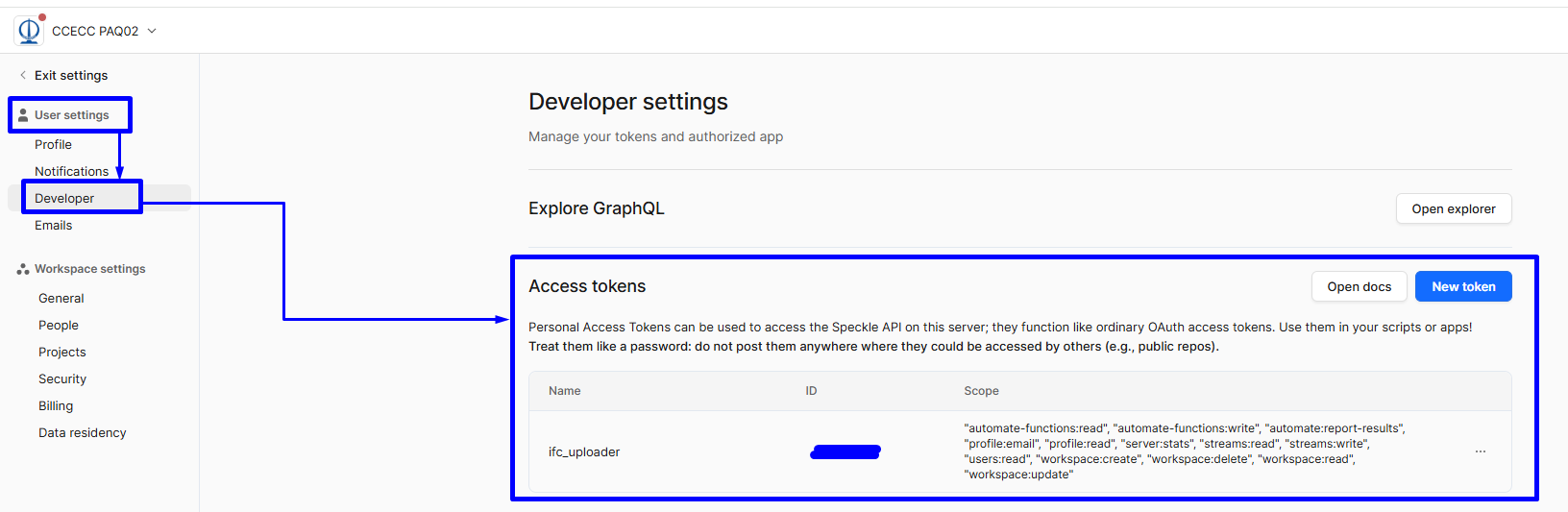

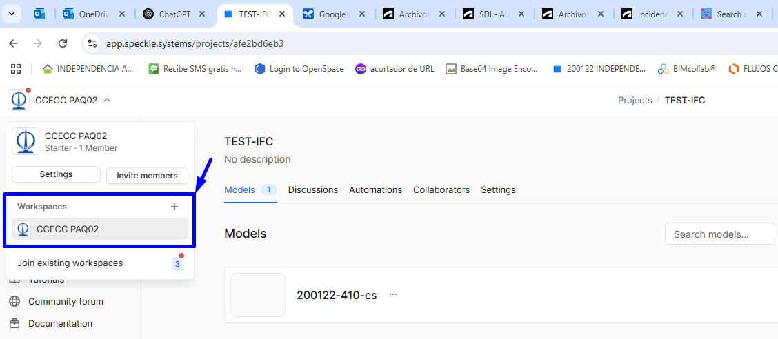

Hi Joff, are you using workspaces on speckle? if not, you need to use it. Please check you token too; be sure to use all the good scopes.
Thanks for the quick responses @oscarazzus .
I have these workspaces.
When I was looking for the option to activate tokens I found this configuration
I don’t know if it is the correct opcionts to activate the tokens.

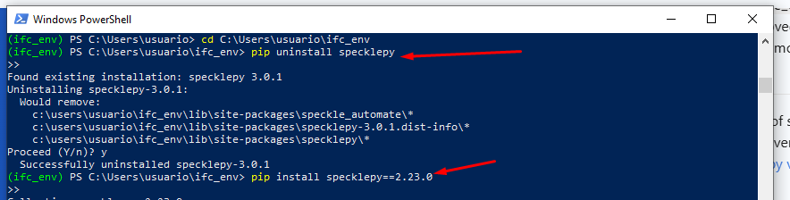

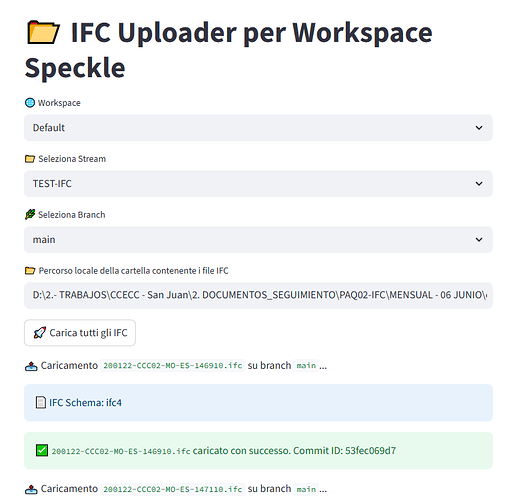

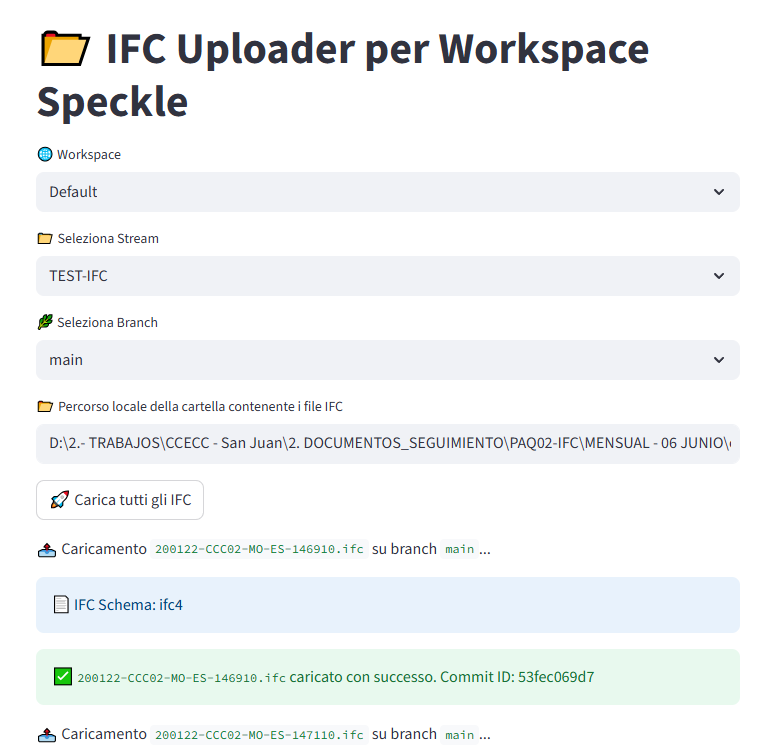

Thank you very much to both of you @Jedd @oscarazzus , Try uninstalling SpecklePy 3.0.1 in the same environment and installing version 2.23.0 and everything works great.
very very nice :slight_smile: I like you are keeping the text in italian :smiley: thanks
