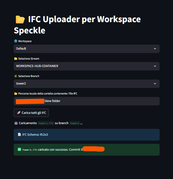

- Launch the app:
bash
CopyEdit
streamlit run ifc_uploader.py
- In the UI:
- Confirm the Speckle URL (
https://app.speckle.systems) - The app uses the embedded token (or you can make it interactive)
- Select the workspace β stream β branch
- Enter the folder path containing
.ifcfiles - Click Upload All
Thatβs it!

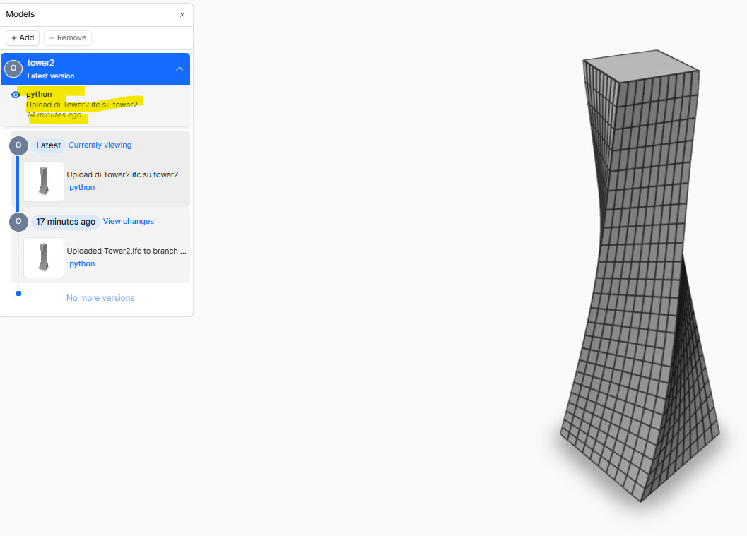

The app will parse each IFC file, serialize it into Speckle format (geometry + data), and send it as a new commit to the chosen branch.
