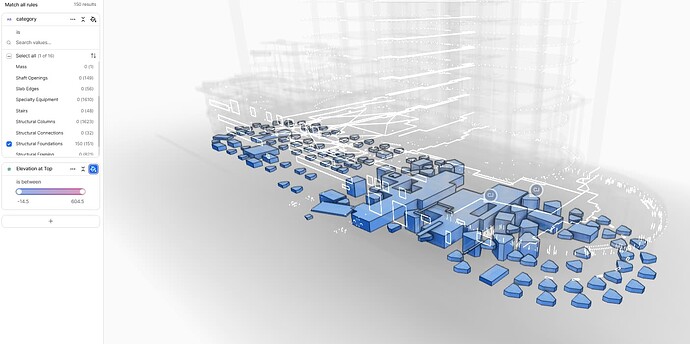

In this sample the end result should be foundations colorized by top elevation. Instead of it being a dynamic value driven setting its forced to a range/scale which elminates the ability to discern values.
If you try to toggle to value not range you are limited to a single entry…so you would have to manually create a filter for every “known” elevation, and the downside if a new elevation is introduced it will not be visible until a new filter is added…so no dynamic behavior
