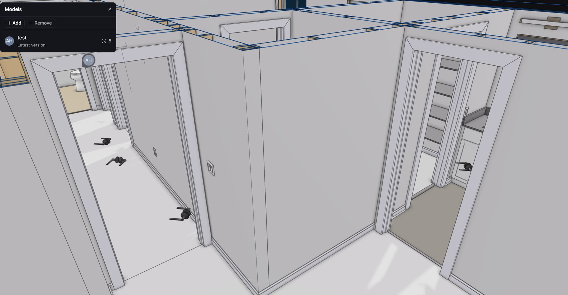

Speckle viewer does not show doors, only their handles
“Hi! I need help. My Speckle viewer is showing only the handle without the door. How can I fix it?”

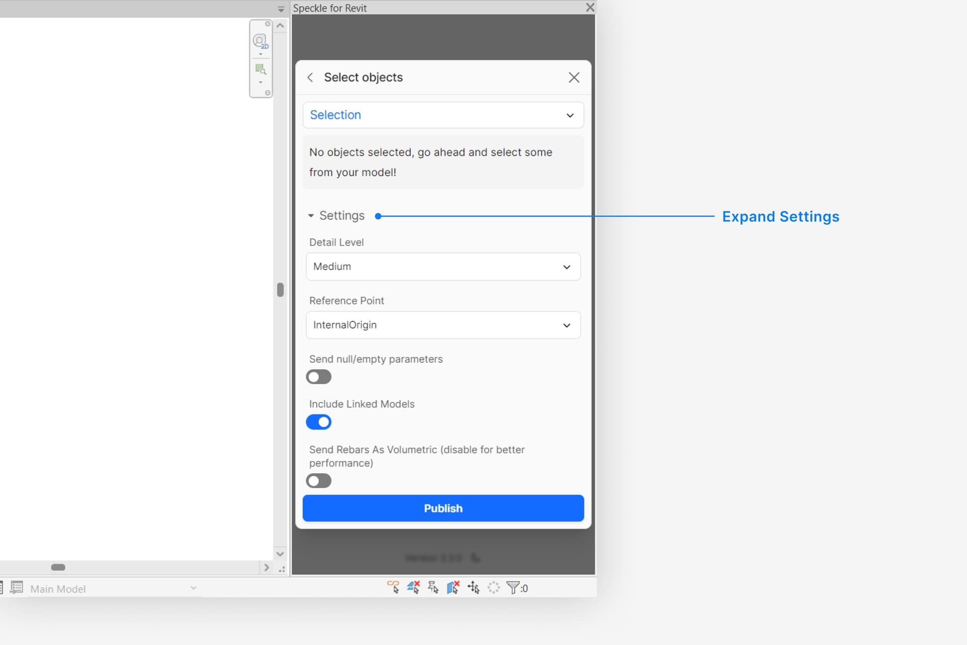

Hi @Andrii_Hutsaluk ,
Was this model published from Revit? If so, you can try adjusting the Detail Level setting to Fine:
Welcome to Speckle @Andrii_Hutsaluk .
Please help us to help you a little here. Where did this data publish from? You’ve posted in the developers channel. Is this your self-hosted server or data on app.speckle.systems? Could you please share the model URL with us? Alternatively, I can invite you to a project where you can upload a single door.
my model https://app.speckle.systems/projects/7ec51c3a89/models/dd414a63dd@943c09091d
@Andrii_Hutsaluk did you try adjusting the setting mentioned by @clrkng above?
