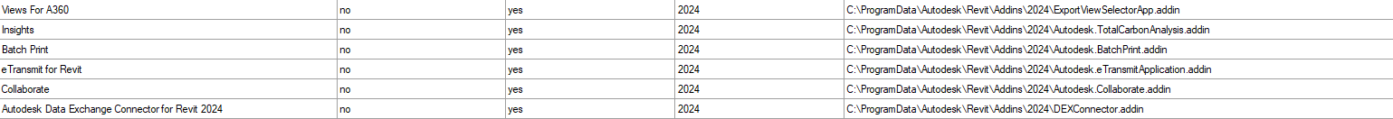

I have run stantec AddInManager application and the only enabled plugins are the following, I guess those are comming with Autodesk, should I also deactivate those (apart from Speckle)?

@oguzhan, I also compared Revit 2024 addins to Revit 2026 addins and Revit 2026 does not have the “Views For A360” and “Collaborate” Addins.
Hey @abertzouanis_EBA ,
Can you try disabling/removing Autodesk Data Exchange Connector for Revit 2024 and try again? We’ve had reports of it conflicting with Speckle.
@gokermu many thanks for your advice! I just disabled Autodesk Data Exchange Connector for Revit 2024 and Speckle works now fine in Revit 2024. Is it weird that I also have Autodesk Data Exchange Connector for Revit 2026 but Speckle worked fine in Revit 2026.
Therefore, conflict issue between “Speckle” and “Autodesk Data Exchange Connector” only exist in Revit 2024.
