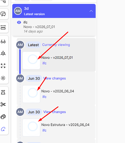

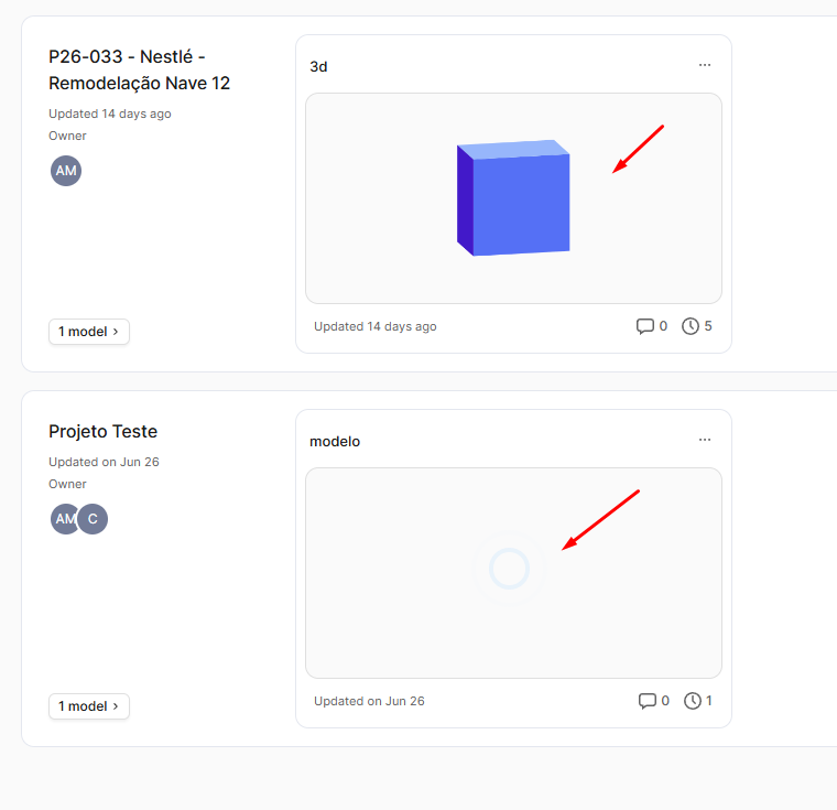

The model previews are not showing up in the thumbnails.
Is this something on our end, or is it a limitation of the self-hosted server?
