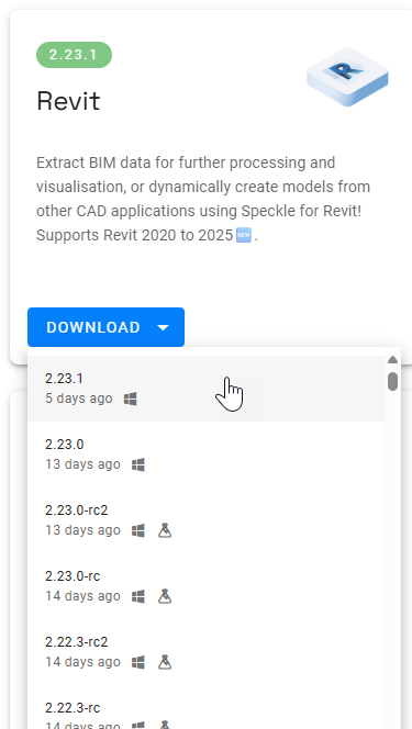

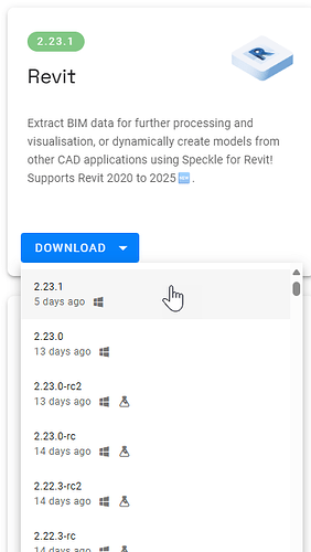

Where can i get the latest Speckle release from as i’m unable to find it from the Speckle releases page.
The latest release in the v3 series can always be found at https://app.speckle.systems/connectors
You are already seeing the latest(last?) release of the v2 legacy connectors.
