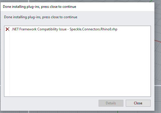

I do not know what happened, in the new rhino speckle plugin
  1. it lost its supports to rhino 8, the legacy model used to supports it.

Hi @tjxme,
  1. Majority of next gen Rhino usage is 8, well it did not lost the support. Something should be happening on your end and happy to assist if you provide where it stuck exactly.

Hi @tjxme ,
It looks like your issue for the Rhino 8 plugin is actually a framework problem from the screenshot that @teocomi shared, and not specific to Next-Gen. See this thread for related issues: No version of Speckle connector is working in Rhino 8.1.23325 - #9 by daniel-fink
  1. Make sure you are using Rhino 8.3 or later
  2. Try a clean reinstall of the Rhino connector: Installing Connectors - Speckle Docs
  3. You can use the SetDotNetRuntime command to change your target framework in Rhino

im actually on rhino 8.5.
when i run setdotnetruntime, what version do i use?

You can set it to NETFramework and restart Rhino.
Also, i recommend updating your rhino to version above 8.9
