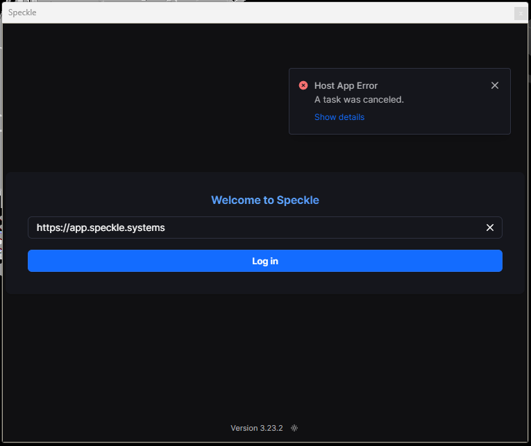

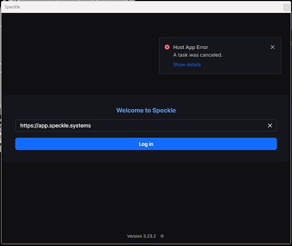

I was informed by Speckle that there was an update for the extension in Navisworks 2026 (build 23.2). I installed the extension, but afterwards I was no longer able to log in to Speckle or do anything with the Speckle extension. I just keep on receiving the error: Host App Error.

That’s the thing… Like I said, I can’t do anything with extension after the update; this included. When I click on “show details”, it doesn’t do anything either.

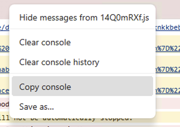

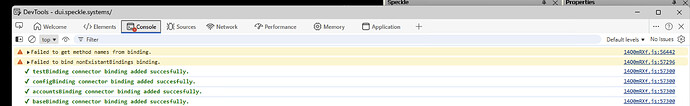

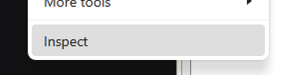

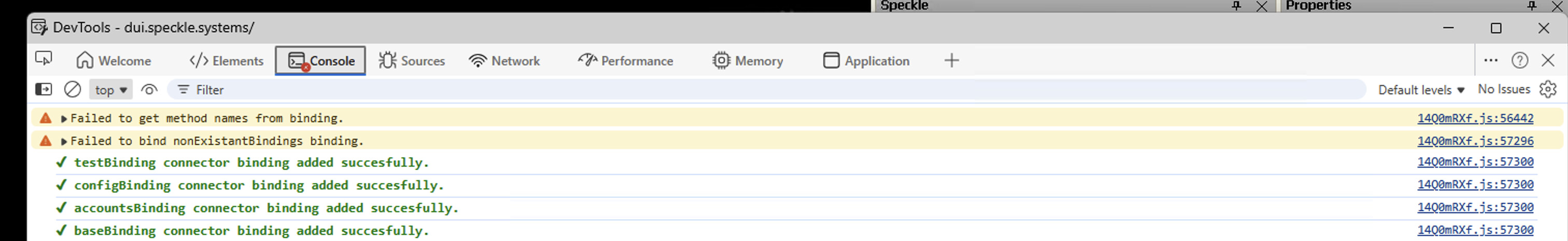

If that error appears again, if you could right click in the speckle add-on and choose “Inspect”
In the resulting window if you could copy paste all the console log here in the forum we can see if there is a specific thing throwing an error prior to reaching our servers.
