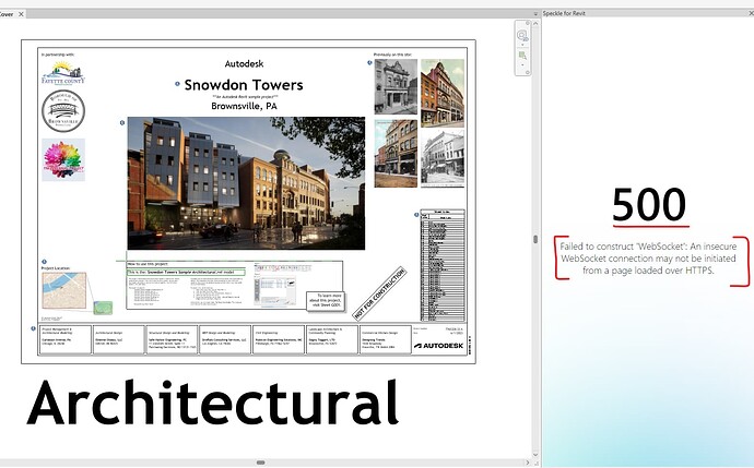

I recently attempted to login to a Speckle Server hosted by my organization by using a custom URL in the connector dialog box.
The Speckle Server I was attempting to connect was on an unsecure http connection due to the lack of a certificate.

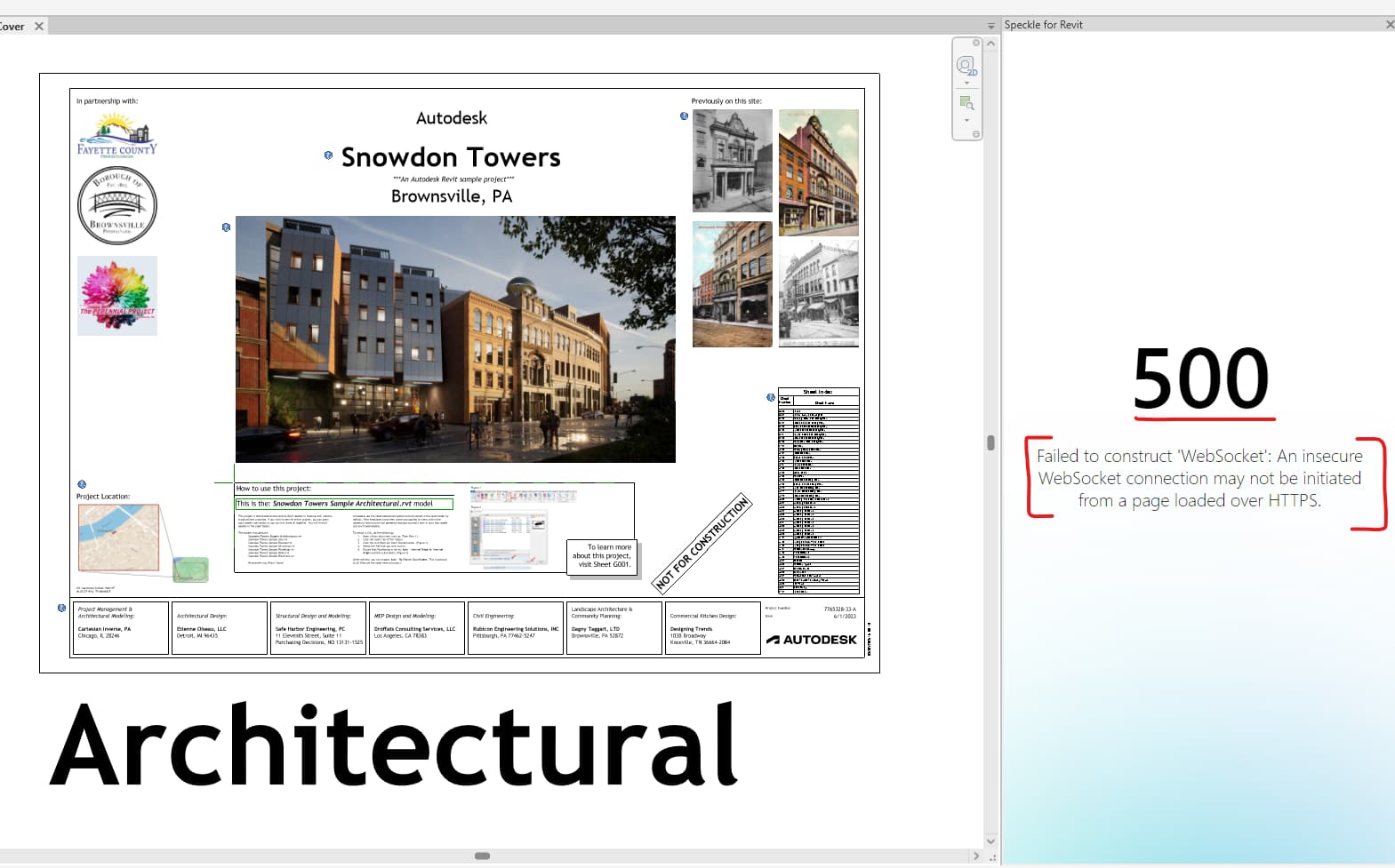

The attempted login seems to have broken the speckle connectors on my computer as I am getting the following error when I try to open the Speckle plugin in Revit / Rhino / Navisworks.
Please let me know how I can fix the issue so that I can proceed to login to the general speckle environment i.e https://app.speckle.systems/ to continue to use Speckle.
Thanks.
500
Failed to construct ‘WebSocket’: An insecure WebSocket connection may not be initiated from a page loaded over HTTPS.
The short-term nuclear option is to delete the Accounts database: %appdata%/Speckle/Accounts.db
If you could try that while no Speckle connector or desktop services are running, and then on first use, you should be prompted to authenticate.
Please report back.
Hi Jonathon,
The issue is resolved. Thanks!
