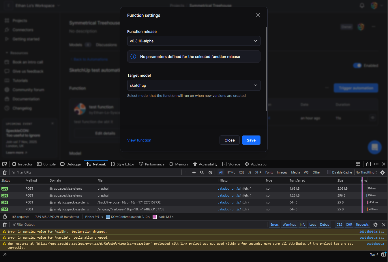

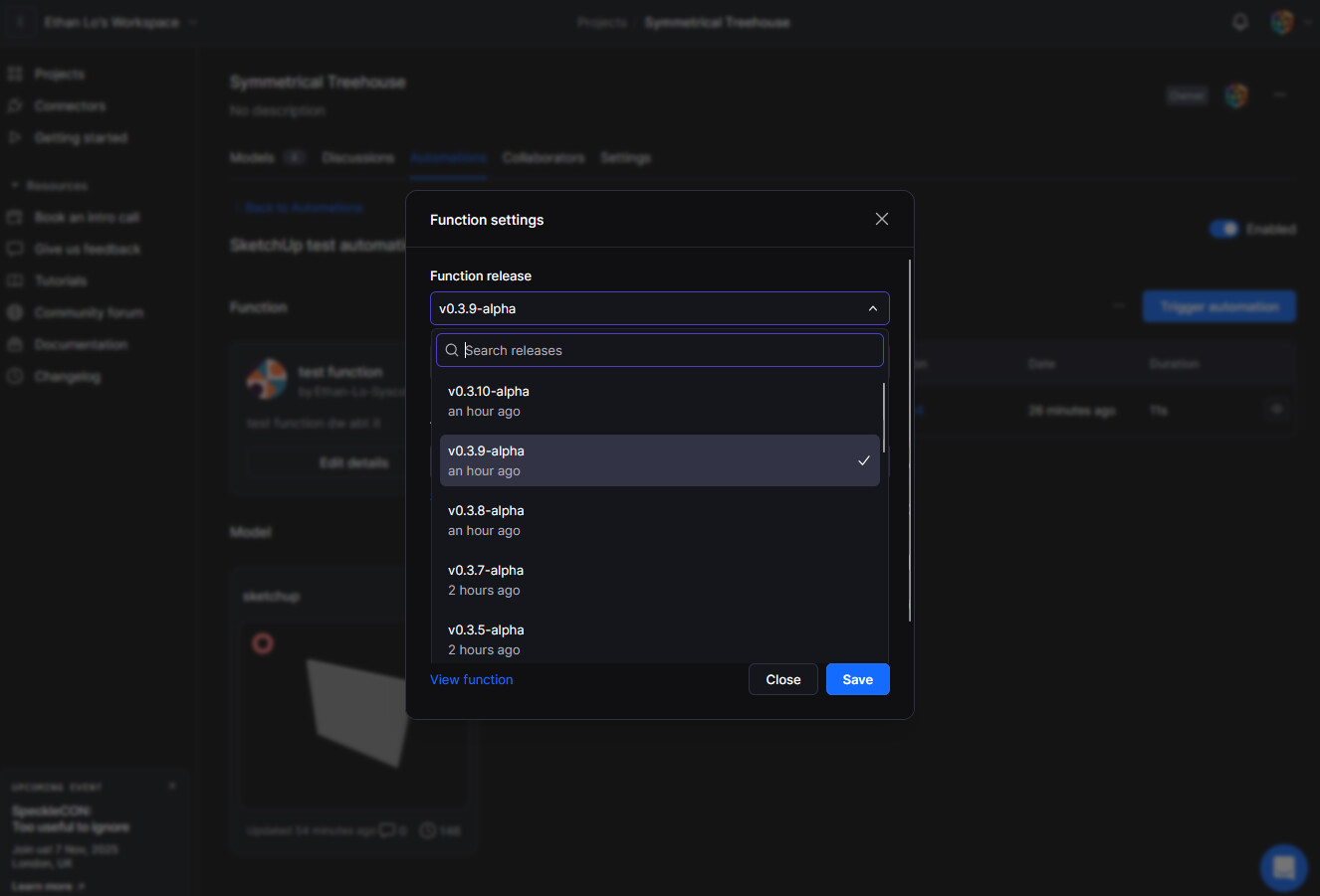

Objective:
  • Update function release to latest release through Speckle Automate details.
Issue:
  • Save button does nothing.
  • Regardless of release selection or model selection, clicking the save button does literally nothing (I opened the web network and console and there is no activity when the button is clicked. By no activity I mean none, no errors, no requests, no responses, nothing).
What I have tried:
  • Reloading the page
  • Clearing cache and cookies
  • Turning off any adblockers
  • Turning off any VPNs
  • Restarting my computer
  • Using a different browser (chrome and firefox) and redoing all of the above
I have found that deleting the automation and recreating it sometimes updates the function to the latest release, but this is not an efficient way of doing this.
Thanks for any help in advance.

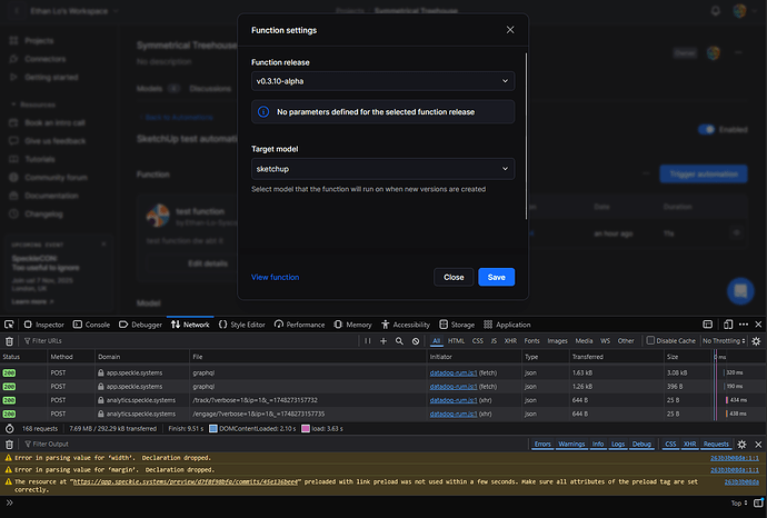

Apologies, @Ethan_at_Sysconverge. This is a bug on our backlog that affects versions of functions with no parameters.
As such if you include a Function Input that isnt mandatory, thiis will allow you to save the function
Thanks for the quick response. I’ll give that a try.
It works :+1:
Thank you for your help!
