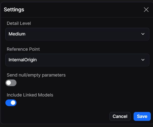

Hey @Cconley530,
Yes, models linked from acc will be sent if included in the send mode. Ensure that the Include Linked Models is enabled (this is by default set to True).
There are three send modes in Revit:
  • Selection - here you have to select each linked model instance that you want to have included in your send
  • Views - here you don’t need to select each linked model instance. If the linked model is visible in the selected view, it will be sent (in other words: the visible elements of the linked model(s) in the chosen view will be sent)
  • Categories - here you don’t need to select each linked model instance. The selected categories will apply to the linked models in the document.
Hope this helps!
