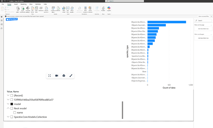

Having trouble visualizing this model in Power BI (2.142.1277.0 64-bit (April 2025)), can someone please help me figure this out?

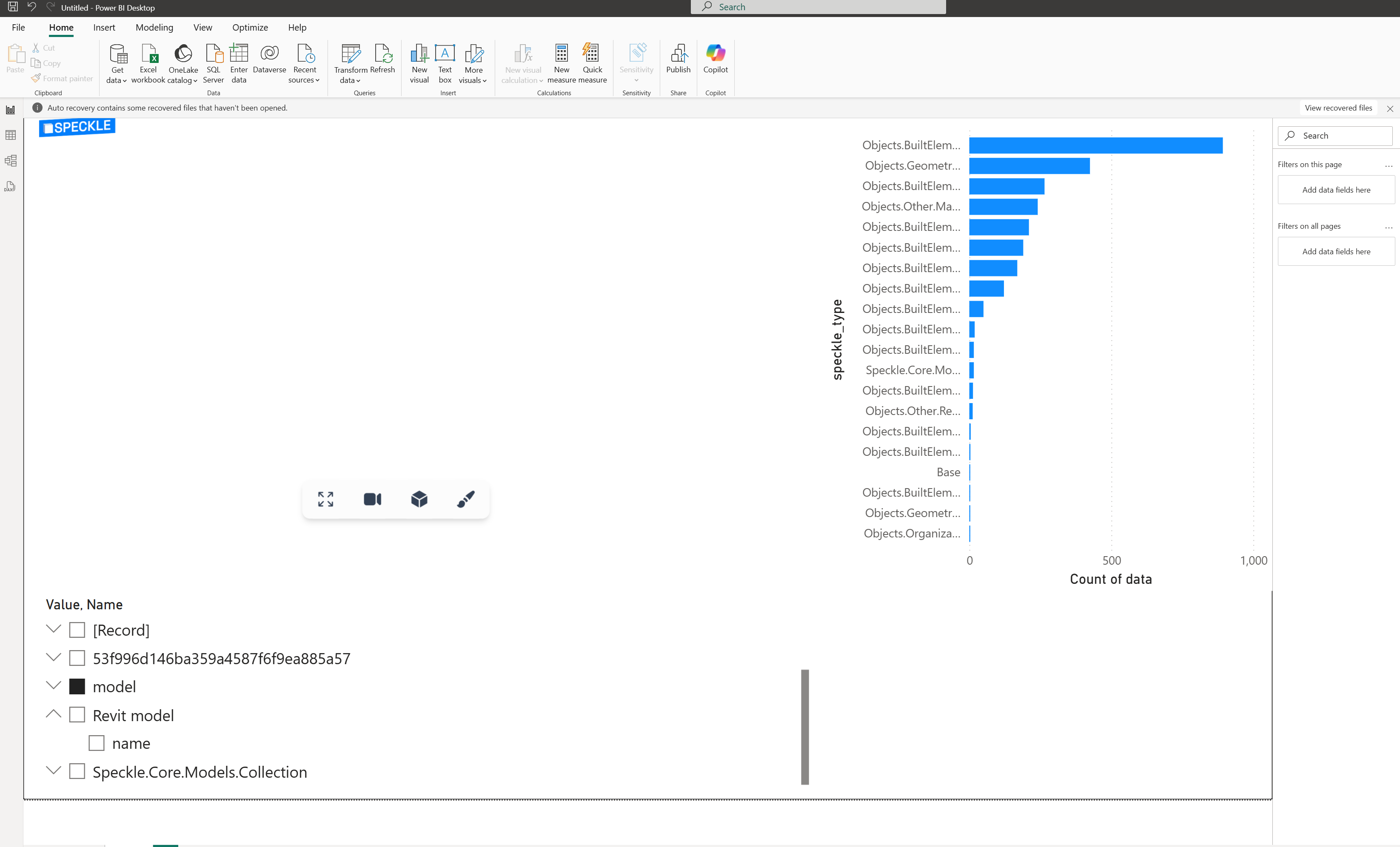

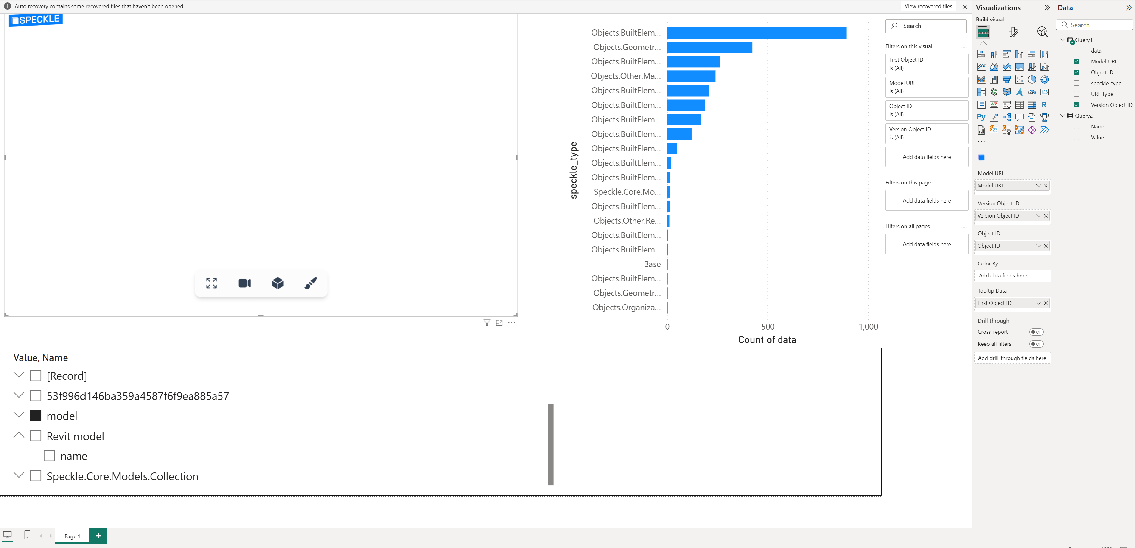

Can you screenshot the whole thing please so we can see which inputs you are using??
Hey @Aprasai,
You are using an old version of the Power BI Connector and the issue is that your project is set to Private. If you set your project to Link Shareble you will be able to see your model.
I will sugest you download the new version of Power BI connector from here: Log in | Speckle - do a fresh install.
After you do this, start a new PowerBI file and try to load the model again with the new viewer.
