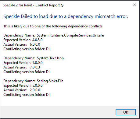

Revit Connector - Conflit report - Revit 2024.3 and 2025.2
This is the message I’m receiving in Revit 2025.2
And this one in Revit 2024.3
Please let me know if you need any other information.

Speckle is not loading, and the plugin tab is also not showing. Yes, Speckle was working fine before, but I can’t guarantee that these errors started after installing Carbon Insights.

Thanks for sharing. At first glance, i don’t see any known conflicting plugins. But I will double check with Idea Statica and get back to you. I appreciate you taking the time to report this.

This is the warning I get:

Disabling the conflicting plugin is the only option as we froze development on v2 connectors.
