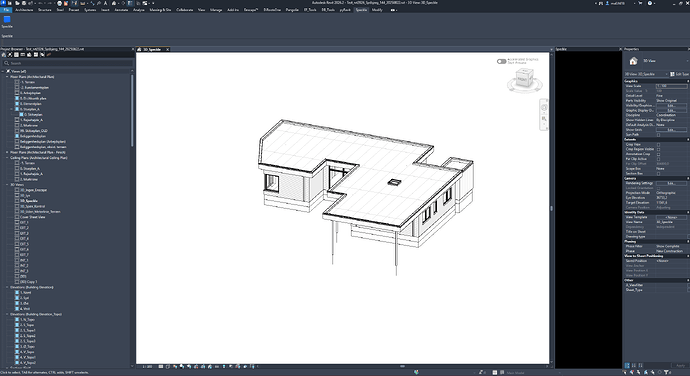

At Real-Time LCA we have a user who has installed the 3.6.3 version of the Revit Connector (we have experienced issues with 3.7.0).
After successful installation he only sees a black plugin in Revit 2026, wheres everything looks perfect and works as expected in Revit 2024.
Attached is the Log file for the Connector.
I looks like it is failing to initialize the Webview

Hey @martinromby ,
I had this issue before but after resetting my laptop, it wasn’t there anymore. Regardless, the usual first check would be a conflicting plugin, specifically: Autodesk Data Exchange for Revit.
Can you check if user has that installed prior to installing Speckle? If so, i’d try uninstalling that and check again.

Hi
I’m the user who had this problem.
It turns out there was a conflict with the great free addin “PyRevit”, and if that’s removed from the load order, it works.
Now, in my company, we kinda need PyRevit for it’s great (and free) QoL functions - so going without it was a non-starter.
Luckily, this is apparently fixed (so far), if we just move PyRevit down in the load order - so removing it is not needed.
This is done by going to the “\AppData\Roaming\Autodesk\Revit\Addins\2026" folder, and renaming the file “pyRevit.addin” to something like “z_pyRevit.addin”.
