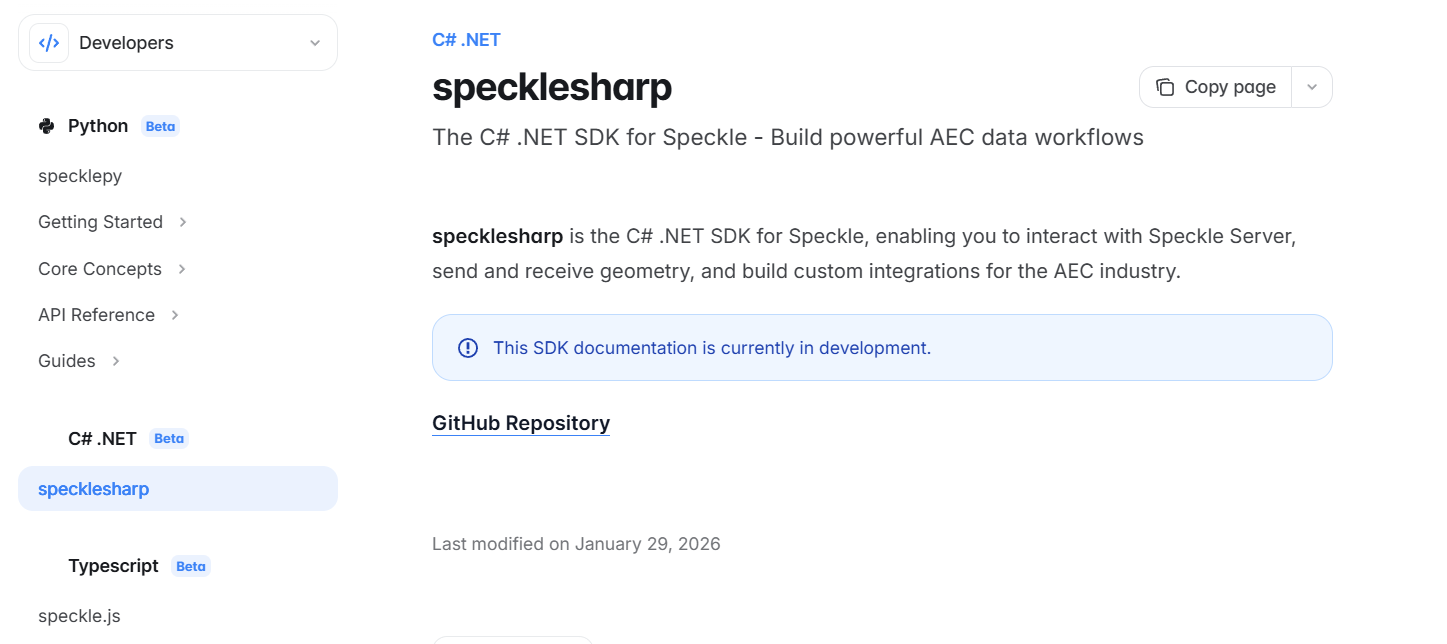

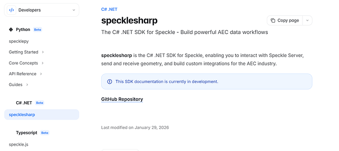

However, I cannot find V3 method document (e.g., sending base objects to Speckle)
Fair, however all our connectors code is open source.
I was trying to describe the conventions first rather than getting to writing code with you.

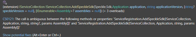

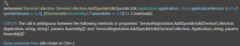

I guess ServiceCollection is from Microsoft DI. However, when I am using AddSpeckleSdk, it pops up an ambiguous issue which is CS0121: The call is ambiguous between the following methods or properties: 'ServiceRegistration.AddSpeckleSdk(IServiceCollection, Application, string, string?, params Assembly[])' and 'ServiceRegistration.AddSpeckleSdk(IServiceCollection, Application, string, params Assembly[])'
Is ServiceCollection Microsoft DI, isn’t it? Please correct me or give me clues if I am wrong.

There are a couple of overloads for AddSpeckleSdk, several have optional arguments.
With the code you have now, the compiler doesn’t know which one to pick because there’s ambiguity.
You can solve this ambiguity, by specifying more args explicitly, or by using named args.
try specifying a non-null string value for the null you’re currently passing in…
if that doesn’t work, then use try using assemblies: [ typeof(Element).Assembly ] instead of typeof(Element).Assembly

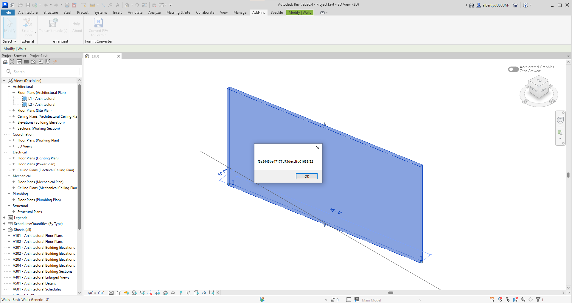

Appreciate your technical support! Very helpful!! When I sent the base object to Speckle, I actually got the object ID. It seems work.
However, I cannot find the object in the assigned project space where I uploaded it. https://app.speckle.systems/projects/dc105e64eb.

MessageBox.Show(objectId.ToString());

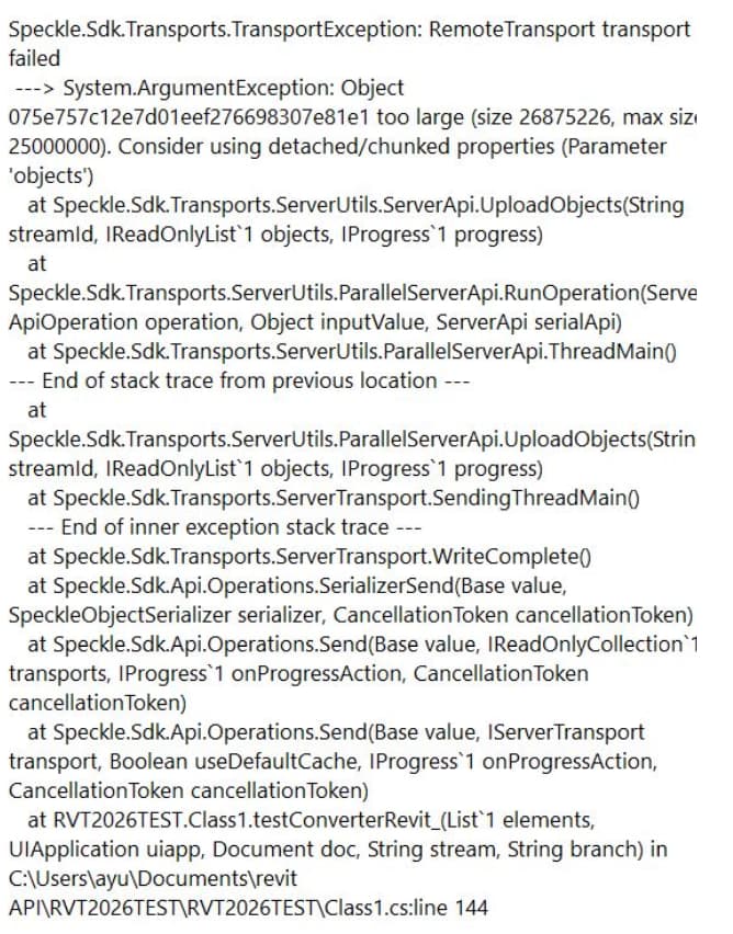

I have to create a converter for myself. However, when I am proceeding with more complex components (16 complex geometry elements, maybe 10000+ mesh), Speckle Transport cannot upload a compound object over 25mb. May I get you advice on this?
var roots = new Base();
Options opt = new Options
    DetailLevel = ViewDetailLevel.Coarse,
    IncludeNonVisibleObjects = true
var root_list = new List<Base>();
foreach (Element e in elements)
    var root = new Base();
    var displayMeshes = new List<Base>();
    GeometryElement geo = e.get_Geometry(opt);
    if (geo == null)
        continue;
    displayMeshes = GetDisplayMeshes(e);
    root["sub-component"] = displayMeshes;
    root_list.Add(root);
roots["asset"] = root_list;
using ServerTransport transport =
    transportFactory.Create(
        account,
        stream
var (objectId, _) =
    await operations.Send(
        roots,
        transport,
        true
Regards,
Albert
Because you’re using Base object as your root, you’re trying to send the entire lot as one really big object… and it’s exceeding certain limits in the stack.
Try using a Collection type instead of Base as the root object, and use the root.elements = displayMeshes instead of “sub-components”, as the elements prop will be detached.
You may also want to read up on Speckle’s Data schema - Speckle Docs, as there have been changes from the v2 days that you many want to adhere to for better compatibility with v3.
Thanks for the solution and shared materials, Jess and Jonathon.
