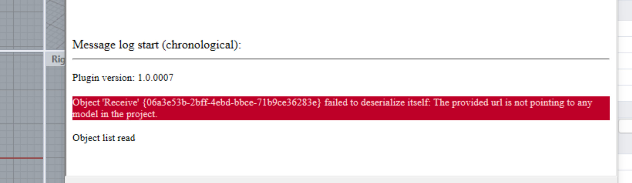

Hello Speckle Community,
I just noticed that when i open my grasshopper file in a new rhino, ‘Receive’ component gets disappeared and each time i open my file i have to bring the receive component manually to the grasshopper canvas. It works fine as i have it open whit the same rhino file that i made the algorithm but when i want to open it in a new rhino file it just automatically gets disappeared.
Is there any tips for that solution?
Niloo
Hey @Niloo , thanks for the report - this should not happen!
Can you confirm:
  • your version of Rhino
  • version of the Grasshopper Connector installed
  • version of the Rhino Connector installed
Thanks for your answer@teocomi.
Rhino Version 7 SR37
7.37.24107.15001
Grasshopper connector : 2.20.4
Rhino connector: 2.20.4
It seems like a bug, I’ll report it internally but don’t have an ETA to share for now - thanks!
