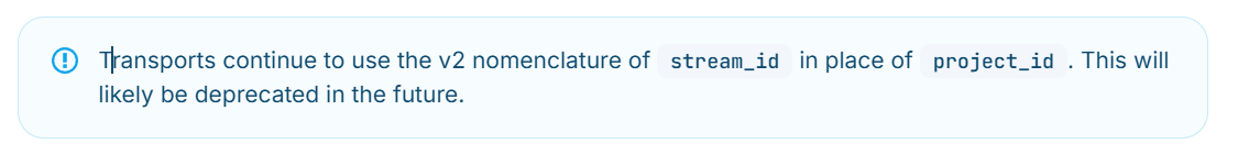

Why does class ServerTransport (still) have a stream_id attribute instead of a project_id attribute?
Because if there weren’t crumbs of history like this, then archaeologists would be out of a job.
Essentially, because reasons but
This is there so noone asks this question :smiley:
Love the answer :spockle_joy: hahaha
