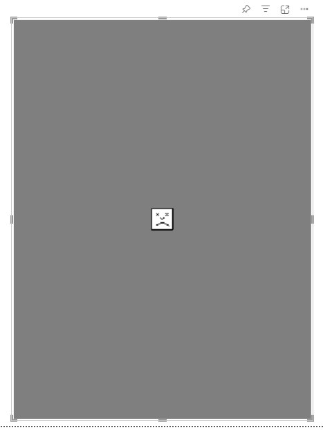

I am having issues viewing a large model on Power Bi,
I upload multiple IFC models to the speckle server, combine them and pull them into power BI (the combined model size is about 1,4 GB , and the Query has about 141K rows) .
When I try to load the model on the desktop version of power BI it crashes (I believe it has to do with available memory).
When I load the model to web version of power BI the viewer loads and after reaching 100% it shows the error below
I am using the latest viewer version and power Bi version 2.145.1602.0
Have I reached the power BI viewer limit or is there a way around this.
the same combined model loads on the speckle web viewer but it takes some time.
I’d appreciate any tips
Br
The memory environment PowerBI offers is a constraint indeed. And PowerBI online is no different.
We have some improvements coming down the pipe for viewer in constrained memory environments like mobile and powerbi, which should help, but also you may wish to review what extent of data is needed for viewing and what is nice to have
