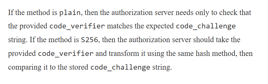

This is from the third link I shared with you
For “plain” methods, code_verifier and code_challenge means the same thing. :slight_smile:
