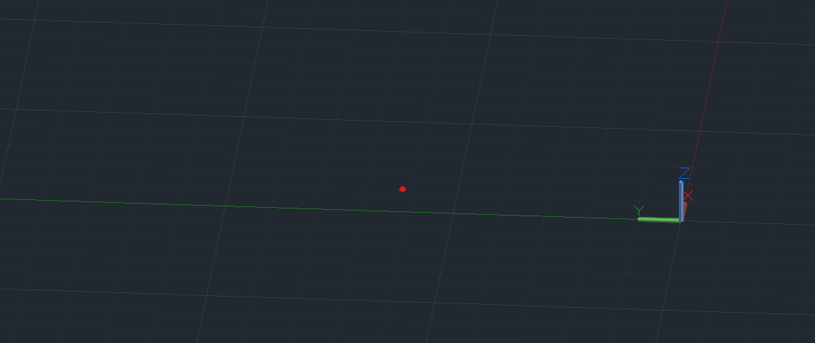

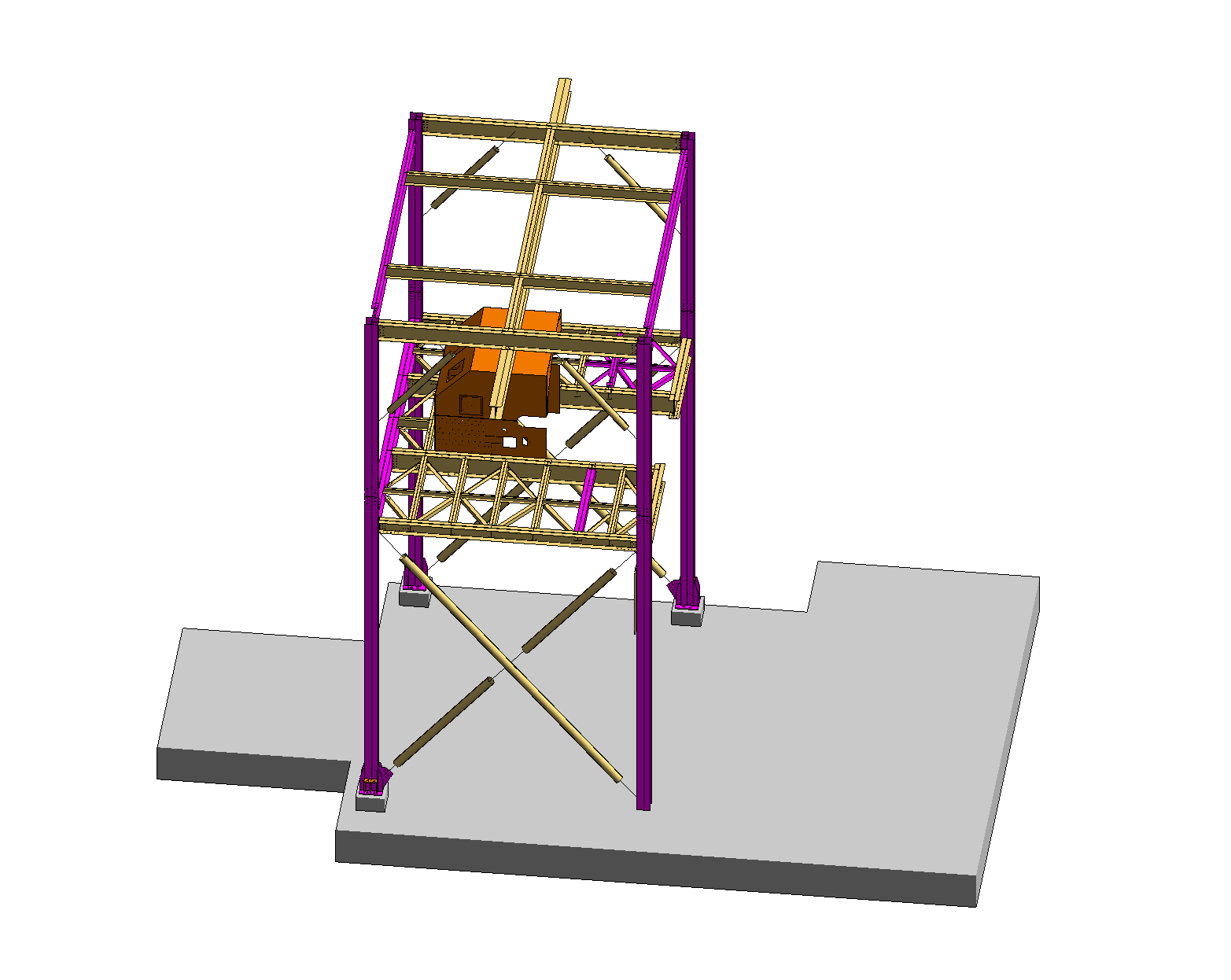

Hello, I need to know how to fix the problem so that objects that are too far from the origin do not appear distorted.
exported in autocad and it looks like this:

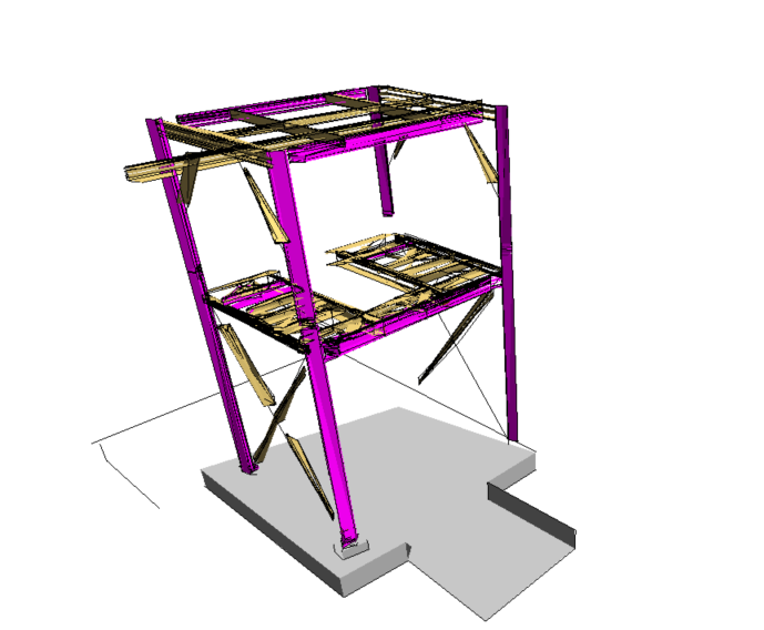

y cuando exporto a revit se ve asi:

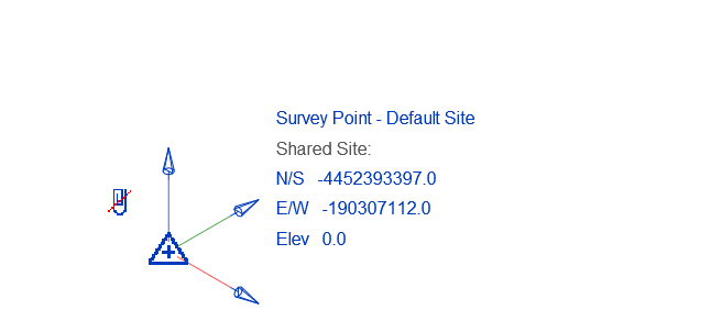

aca para hacerse una idea lo lejos que esta del origen:
I need to know how to solve the geometry that I get in Revit, please.

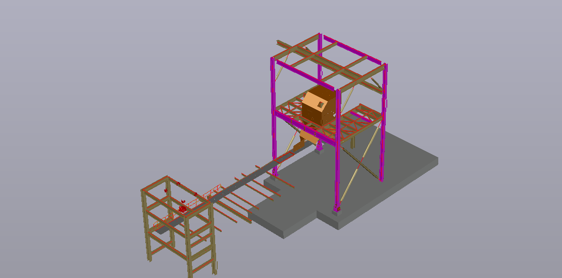

This is the same model we covered here no?
Hello @jonathon it is the same model but from a different Navis file, since it is a more recent version :slight_smile:
I’ve shared a Speckle Project with you to upload the model to.
Sorry, for various reasons I lost my previous projects but I’m sharing the current spleckle project with you so you can see it. I see that when you do it you don’t have any problems. The RVT extension model you sent me was very useful, but now the model has been updated in coordinates and details.

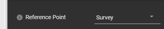

I have been investigating and I understand that I should export with the project coordinates so that the model does not throw it so far away, but I cannot do it.

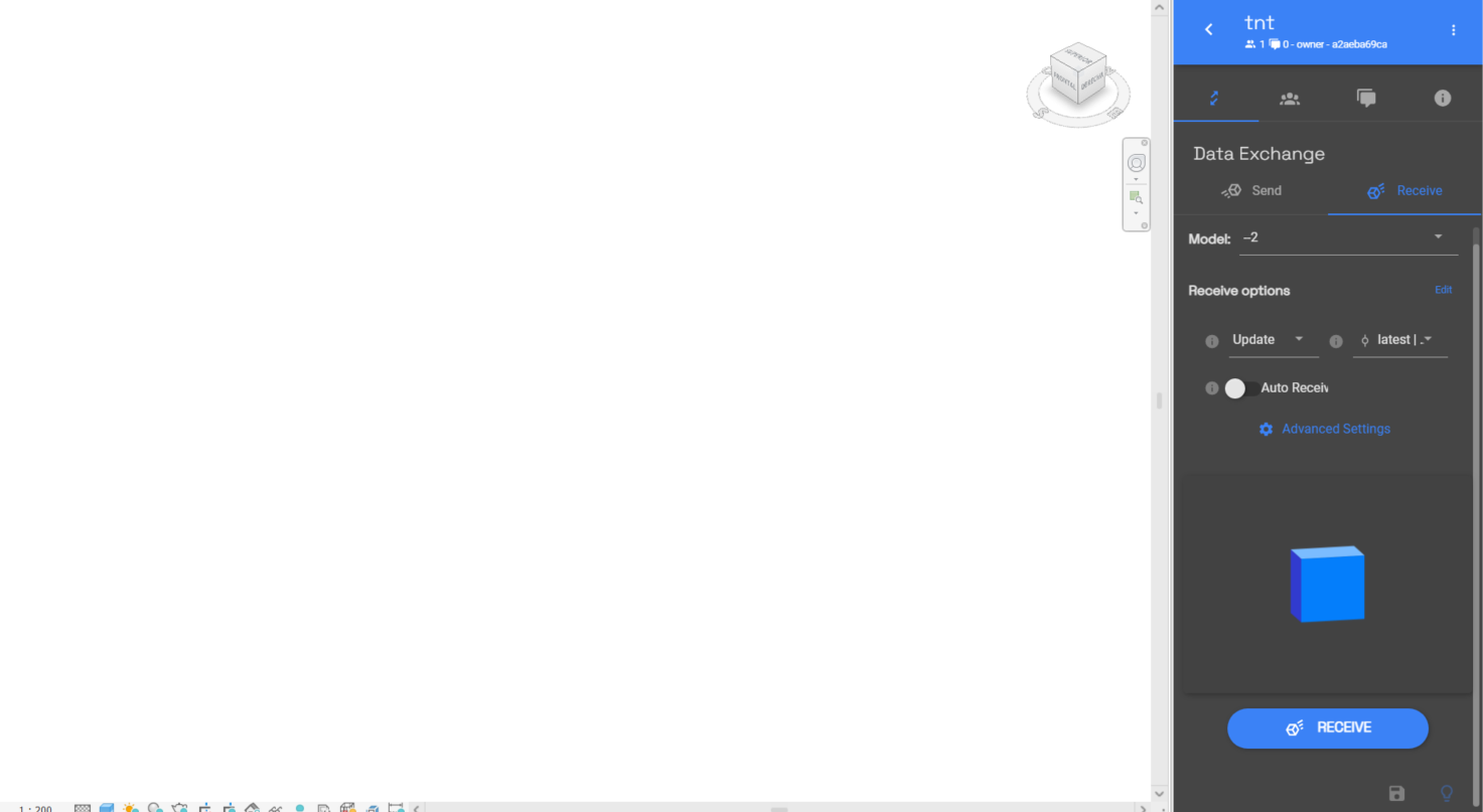

Alternatively, as it was before, if you have you Shared Coordinate System set up in Revit, using the survey point, you can receive (with v2) the geometry in the right place - although to be honest depending on where this is in the world, the coordinates look off to me.
Revit receive settings.
Wow, I feel really stupid, haha, thank you very much. I still don’t understand the solution and how to use the survey point because maybe I’m not using v2.
The Navis models you have published and the shared screenshots are all v2.
This may be a confusion. Our Next Gen connectors we refer to are all v3.
v2.21.4 i believe is the latest build for Navisworks and Revit.
So if I understand correctly, I have to select the geometry that I’m going to extract from the model, I send it to the speckle servers, but when I go to do that, do I have to select the project base origin option?
