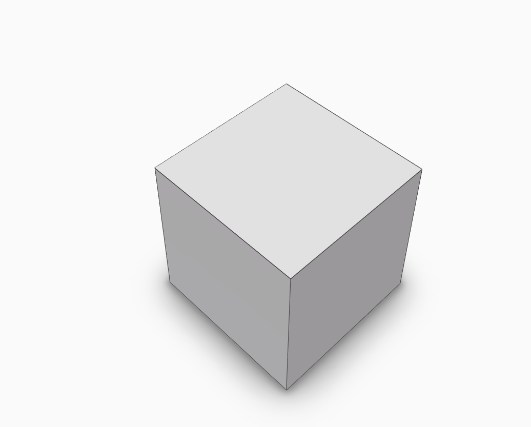

I’ve created a simple example with a box from Blender:
Before Upload

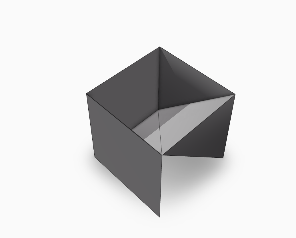

After Upload
I don’t add any properties to the box, I just fetch it and reupload it again.
As you can see, the faces get mixed up.

Someone is looking into this @chrkong and it relates to the indices ordering.
Thank you for the detailed repro steps!
I believe the issue is on load with the fullyTraverseArrays: true
setting. Omitting that or setting it to false causes the indices to be correct.
I’ve been hard at work on @speckle/objectloader2 - npm which doesn’t have this setting.
However, trying to use it on your project as given me things to do to make it work better for NodeJS. Currently, it’s optimized for the viewer.
Let me know if this fixes you and what else would help for OL2
