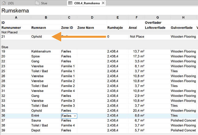

For some reason if you delete a room and it becomes Not Placed then it still shows up in Speckle.
Delete a random room in Revit.
Deleted room in Revit is still in db but Not Placed.
When sending a new version to Speckle the room is still shown.

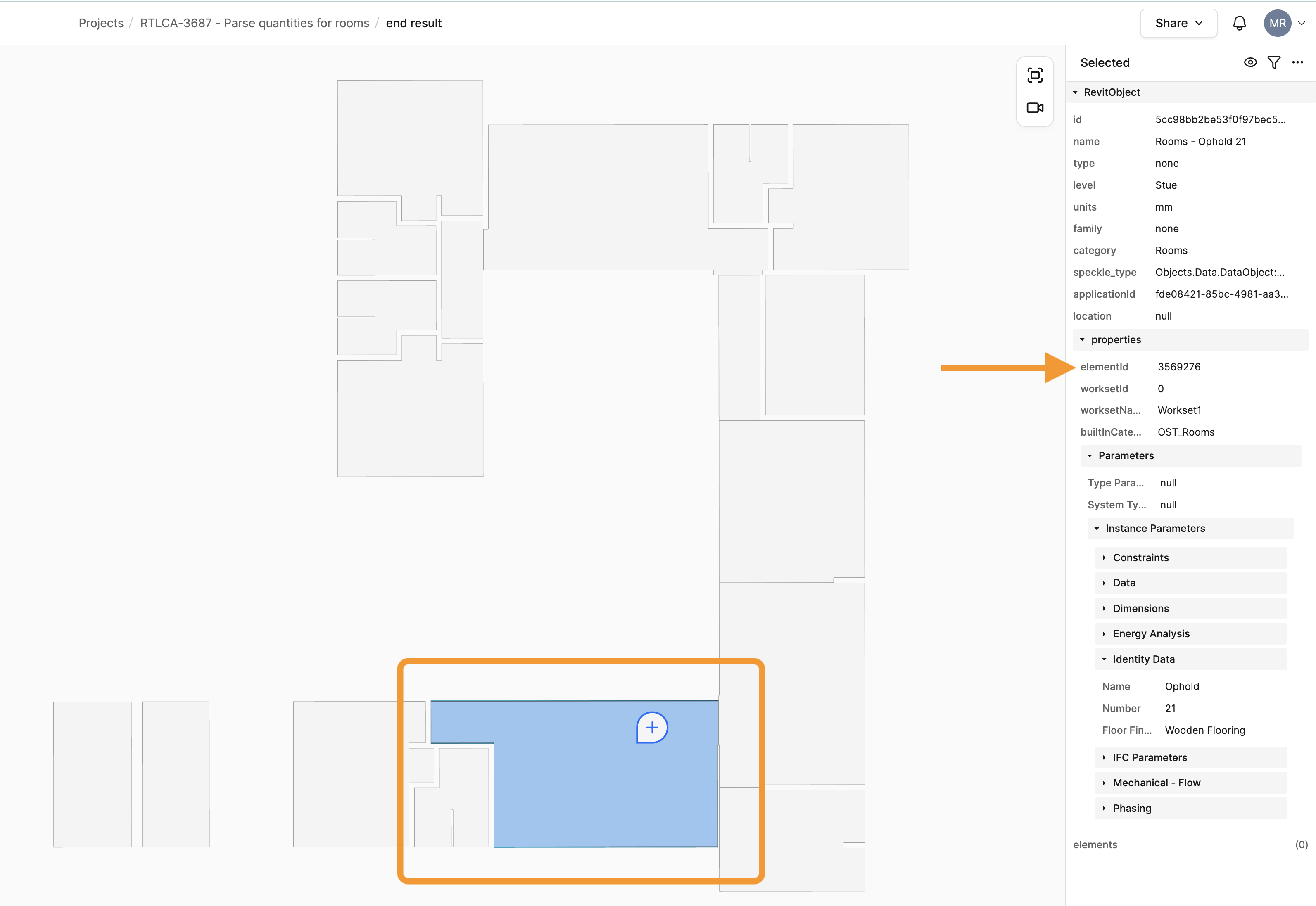

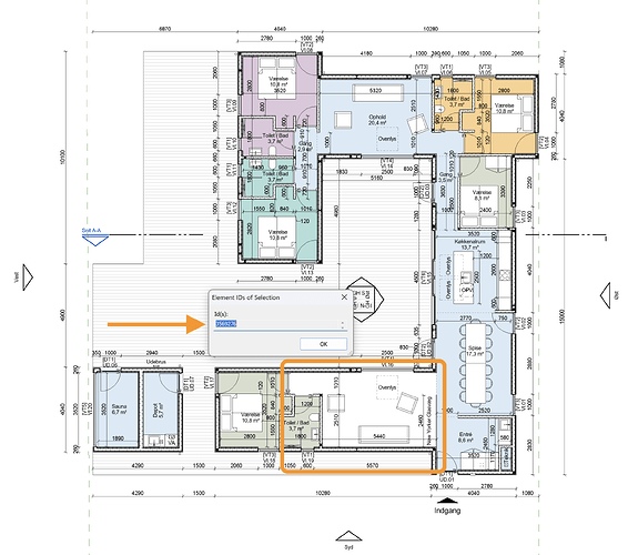

Hmm, this is a tricky one. If it’s in DB, it’s normal that we extract it. But it should NOT have the room geometry. I’ll check this.
gokermu
(Mucahit Bilal GOKER)
4 February 2026 07:53
3
@martinromby I looked at this and it seems not placed rooms still have geometry associated with them in the DB. I’ll raise this internally on what to do here. I think we either won’t send not placed rooms (which i have doubts about) or add it as a setting.
