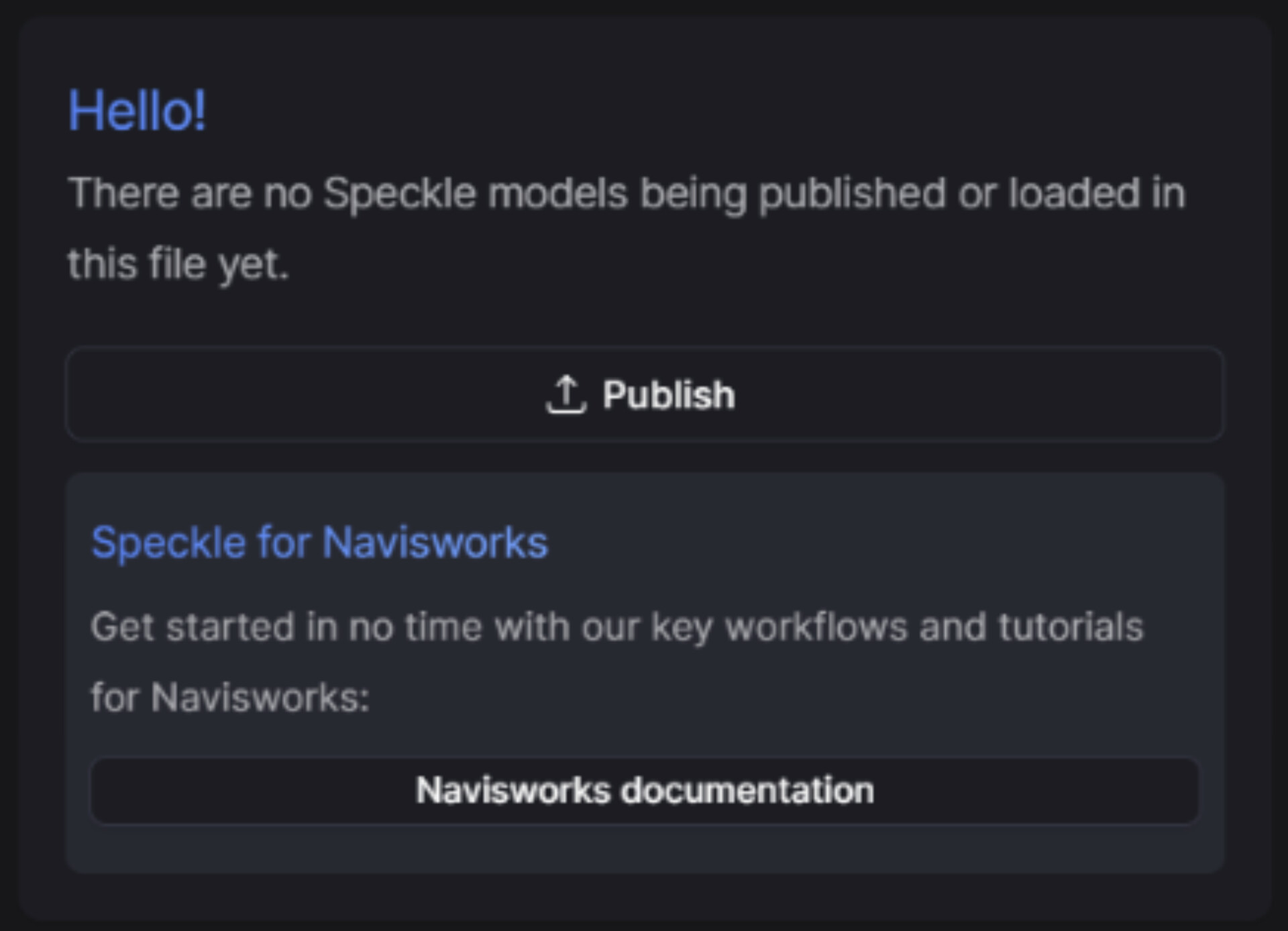

Not able to load projects using speckle and naviswork
We have hosted our own speckle server, all seems to be working fine.

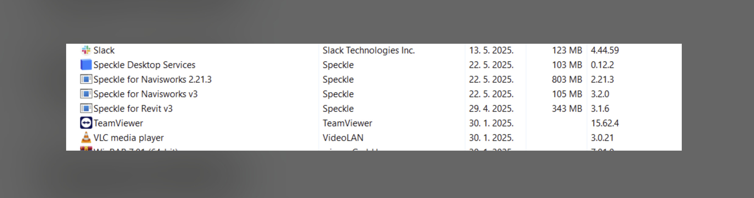

We are using speckle connector v3 with v2.21.3 and Navisworks 2025.
For some reason whenever speckle connector gets updated, we face this issue multiple times and to fix it we need to uninstall/reinstall speckle connector.
But this time it’s stuck, and doesn’t seem to help.

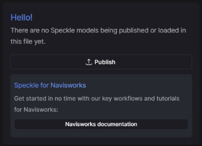

Here’s a preview

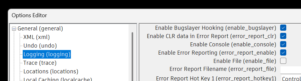

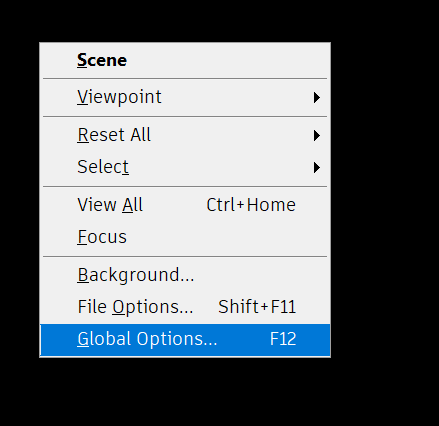

Could you enable the Navisworks console log to see if it shows errors reported from the server?
To enable the console:
Press Shift when choosing Global Options
The General > Logging > Enable Console
You should restart Navisworks and see what displays in your video when running through those same steps.

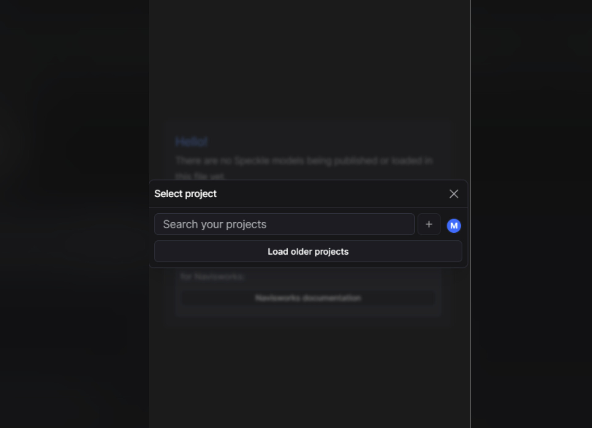

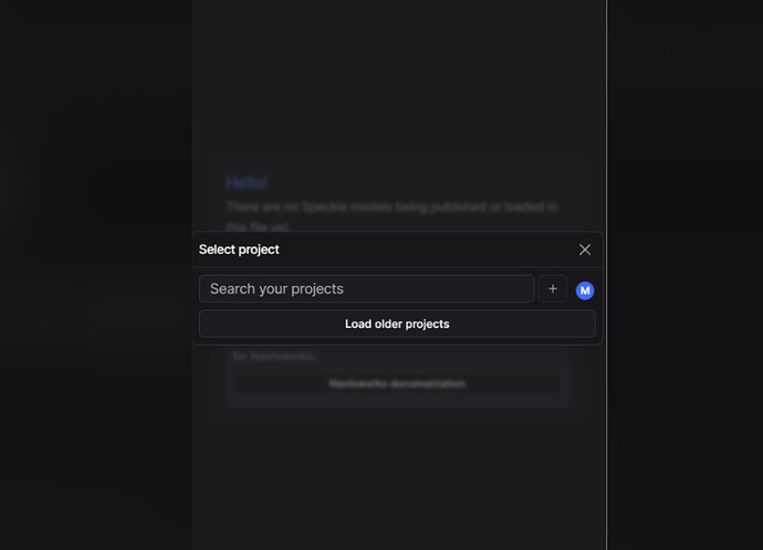

Here is a preview of the errors, currently Navisworks 2023 is in use.
The speckle browser doesn’t open up, same happens with 2024

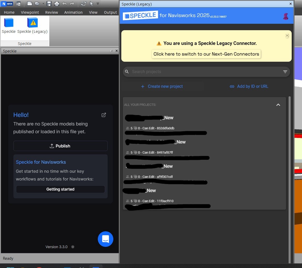

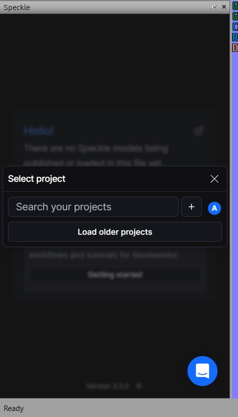

I tried using both the connectors, first V3, and then the legacy connectors.
I wasnt able to load my projects in speckle connector v3

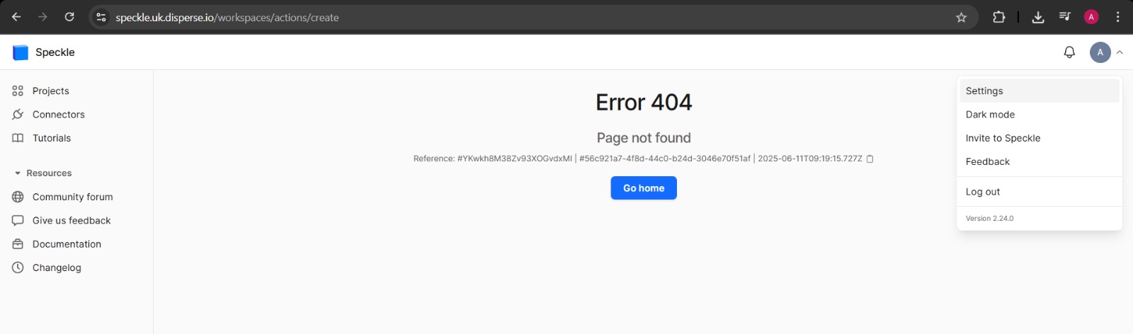

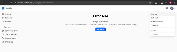

Secondly I noticed I’m not able to create workspaces, when I goto the /workspaces route
I’m running Speckle Server version 2.24.0
I’m attaching my logs as follows from the connector for Navisworks 2025
SpeckleCoreLog20250611 (1).txt (14.2 KB)
You are unable to create workspaces on a self-hosted server as it is not part of the Apache2 open-source license.
The Speckle Enterprise Edition (EE) license (the “EE License”)
If you wish to enable this, this can be arranged as a paid component.
The connector errors you are experiencing are very likely related to needing to update your server to the latest version, which is 2.25.7
