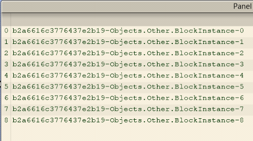

It seems that when I send blocks (using the standard Speckle components), the objects do not retain a unique applicationId. This makes it very difficult to perform accurate diffs between versions, as I can’t reliably track which object is which across commits.

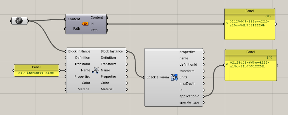

Grasshopper requires you to synthesise an applicationId if you expect to rely on it.
You can then add it as a prop by key…value
Hey Jonathan, Thank you for your reply, it works, but not on Gen 3 connector, when i try to add it as a prop, it won’t overwrite the applicationId generated by gen 3 connector. Any workaround for Gen 3 connector?

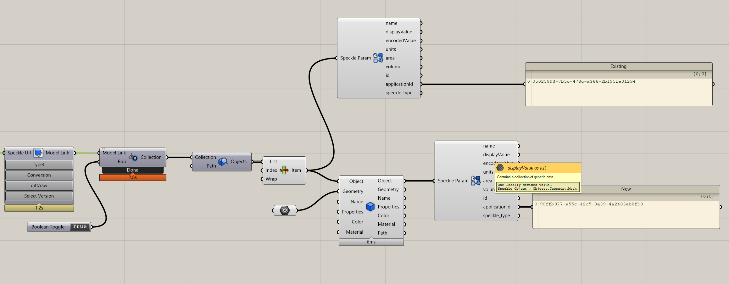

Thanks Claire, I have another question regarding this, how can i update the geometry after streaming in my object, while keeping its application id? Is this possible?
Yes this is possible: you can use the Speckle Object passthrough node to do so.
Make sure you input your original object as the first parameter (a model object, or another existing speckle object), and you can input a different geometry into the second geometry input. This will leave the input object applicationId unchanged.

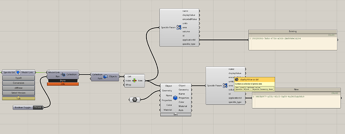

Hey Claire, I tried doing this, but the applicationId still changed, see below image
Did i missed anything?
Cheers,
Ray
Can you confirm that you are using version 3.5.1?
