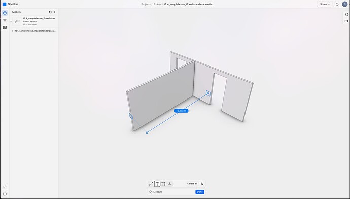

Hey,
i quickly spun up an instance of the server without workspaces and it looks like this:
This version does have the redesigned viewer layout that you are looking for. What version is your server currently on?

Well that looks ace. But no that’s not what we see. We have installed using the guide to install on Digital Ocean using docker. Currently running 2.26.8-alpha.1226 which i think is the latest?
Hmm, actually we have released 2.26.8 since that, so you probably should update to that, but tbf that does not really explain the viewer differences. Pls double check you are running the latest components for all items in the server.
@gergo - thanks for that! I was using the :latest flag for each image in the docker compose file. But for some reason that wasn’t working. Now I’ve specified version 2.26.8 directly it has all updated nicely including the viewer. Thank you!
