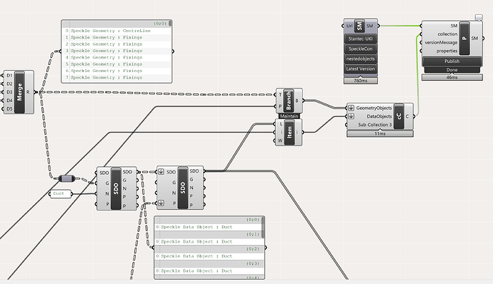

I wanted to check what the intended behaviour is for nesting speckle geometry objects (SGO) in within speckle data objects (SDO) is.
I had assumed we would be able to nest SGO within SDO and they would retain their names and properties etc.
however the nested objects loose all additional properties associated with them and revert to their basic geometry form.
My intention was add meta data to the base geometry so when I deconstruct the object on the other side I still have reference to what it was rather than an array of basic geometry.
i.e this geometry is a beam representation, this curve is the centre line, this curve is a connection point…
See test example below, which shows the SGO names overwritten by the SDO and properties dropped, Is the workflow i describe intended to be possible?
Can you share the model version URL?
an example can be found here: duct-example - NestedParts-Test | Speckle
I’ve added the base geometry as a separate collection GeometryObjects and the combined assembly DataObjects
the Geometry objects have some base metadata attached, in this case typically just name but also the flanges contain their offset etc
however when you receive the DataObject this data doesn’t seem to persist.
