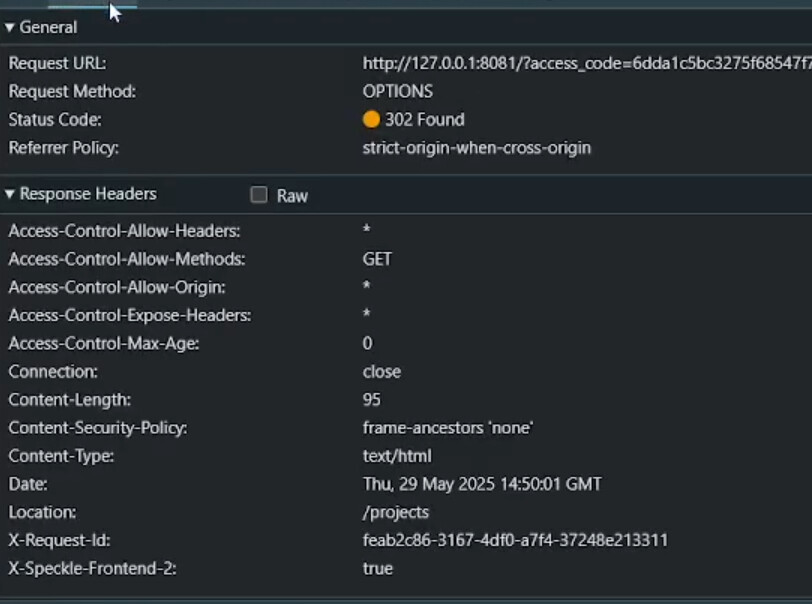

The actual CORS error stems from the fact that the OPTIONS preflight request that browsers fire when requesting URLs w/ CORS enabled is getting sent back a redirect status code. This is unsupported, because the only purpose of the OPTIONS request is to get CORS configuration info back from the server in the form of response headers.
But that is not happening on my end and shouldn’t be happening on your end either.

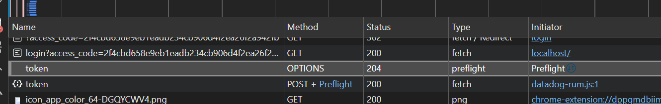

Thanks for the video and for checking all tabs in there, but could you rerecord it again and this time also inspect the OPTIONS requests, their responses and headers?
To see which are OPTIONS requests you need to enable the “Method” column in the network tab, and to see the actual requests themselves you also need to turn off the “Fetch/XHR” filter, because the OPTIONS request is technically not a fetch call.
Hey @fabians ,
I just went ahead and did recording with of the sign up process agian. I have the option redirect error shown as well. Heres that video.
On a side note, I was able to successfully create an account & sign in once on Microsoft Edge this morning when I first launched the web-app on my WSL2; however, when I tried relaunching the web-app, the same authentication issue started happening again on Edge & Chrome.
Recording URL: https://drive.google.com/file/d/1VmASZd3NB6p1UtcwvzcvlGEtoQNruHgX/view?usp=sharing

It’s unexpected that it redirects you to /projects (even outside of the fact that there’s a redirect in OPTIONS)
@Leul_Tesfaye
Good news, I was able to replicate and fix the OPTIONS redirect issue. It changes the way CORS works on our end so i’m hesitant to merge it today, but you’re welcome to try this branch out yourself: fix(fe2): cors OPTIONS reqs sometimes returning redirects by fabis94 · Pull Request #4860 · specklesystems/speckle-server
