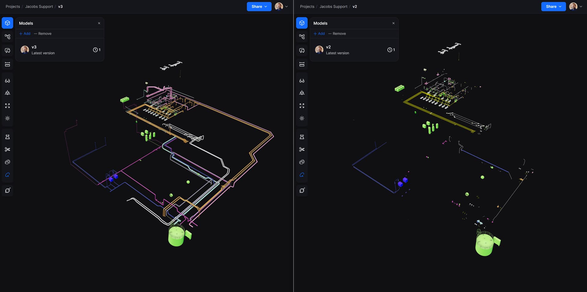

@AndyD314 Sorry for the delay, and thanks for the source file - If you update your Navisworks connector in Manager, it now comes bundled with the v3 next-generation connector, which appears to resolve this issue already.
I took a day or two to get this checked as we are polishing off a few things on the connector, which will soon be announced.
v3 on the left - v2 on the right

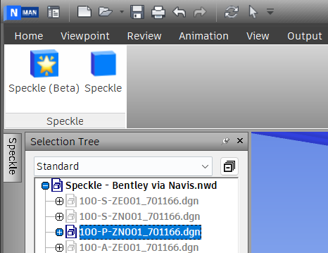

Thank you, this is great. I’ve just updated to 2.21.4 Navis Alpha connector… is that the new version?
Nothing has changed Naviswise in that release - bt the speckle menu should show both installed - look for Speckle (Beta)
Seems the “Speckle” tool still doesn’t load all the content.

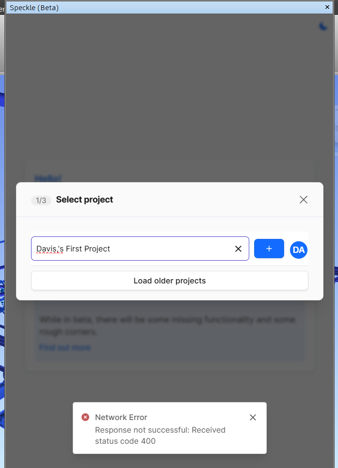

The “Speckle (Beta)” tool gives me an error when trying to publish.
Let me know what you think, thanks for the help.
may be a project access issue with the Speckle (Beta) tool…
Any chance you could describe said error?
it seems I’m not able to connect to my project… image in last chat.
I can look into that error - is that to a jacobs server?
yes I think so; https://ldd-emea.jacobs.com/
Could you please provide more information to narrow down the problem? It would be nice if I knew when exactly this error popped up so I could reproduce it. On project search? On Publish dialog open? etc

Thanks, ya it seems to be almost immediately when you click publish and it searches for a project. Nothing is returned in the search.

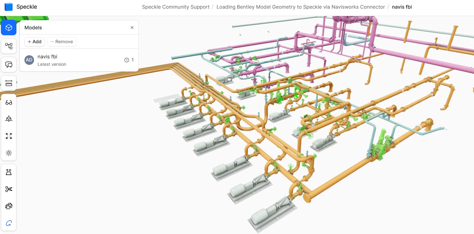

Thanks All, the server change worked, models uploaded perfectly, including equipment tag properties !  Thanks for all the help.
