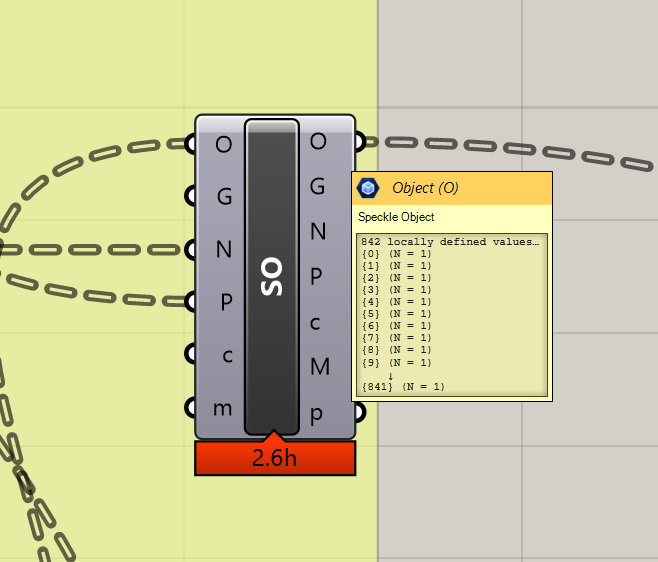

Instead, I still would like to know the size of my models in the server to manage performance. For example, yesterday I was trying to create speckle objects with complex geometries and the “speckle object” component took more than 2 hours to load 842 objects (see image below). This time is directly proportioned with the time to send a commit to the server and I imagine, also the size of the model.
So far, we are blind about performance, maybe we can improve something on our end but we lack of metrics to do so.
