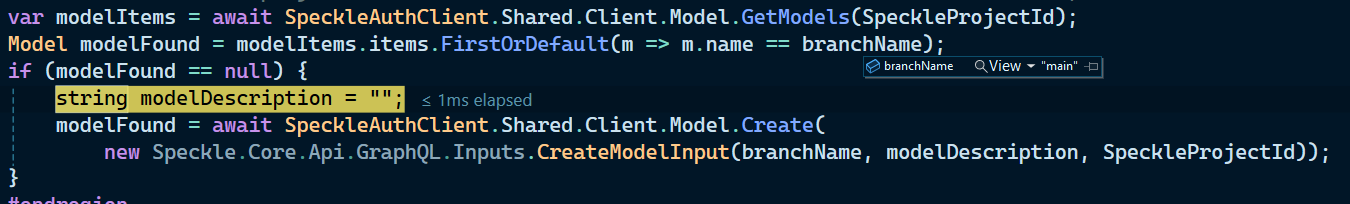

  • I have created a new project and before publishing data to the project main model, I want to make sure the branchname exist. However, the query is not returning model data:
 Project projectFound = await SpeckleAuthClient.Shared.Client.Project.GetWithModels(SpeckleProjectId);
            if (projectFound == null) throw new Exception($"Speckle Project not found with id: {SpeckleProjectId}");
            //Model modelFound = projectFound.models.items.FirstOrDefault(m => m.name == branchName);
            var modelItems = await SpeckleAuthClient.Shared.Client.Model.GetModels(SpeckleProjectId);
            Model modelFound = modelItems.items.FirstOrDefault(m => m.name == branchName);
            if (modelFound == null) {
                string modelDescription = "";
                modelFound = await SpeckleAuthClient.Shared.Client.Model.Create(
                    new Speckle.Core.Api.GraphQL.Inputs.CreateModelInput(branchName, modelDescription, SpeckleProjectId));

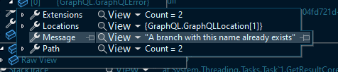

-When trying to create the main model, the api complains with this issue:

Meantime, I implemented this try and catch behavior
            try
            catch (SpeckleGraphQLException ex) {
                string messageError = ex.Response?.Errors?[0].Message ?? "";
                if(messageError != "A branch with this name already exists" && branchName != "main") throw ex;
and looks to working around the issue. Thanks for the insights about the api behavior. I will explore querying a model with empty name or just creating a model with a name different than main.
