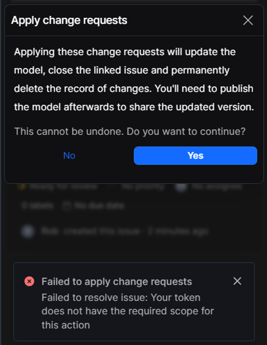

  • One minor issue I see happening is that I get some errors displayed on not having the right scope for my token. However, the parameter updates in the issue are still performed, so I’m not sure what error is actually happening, and if it’s a real problem. Below the link to one of the issues and a snapshot of the error.
    Unfortunately I cannot invite you to the project myself as I’m not an admin of our own workspace, so for now you probably can’t directly access. Guess we can get that arranged if it would help.
