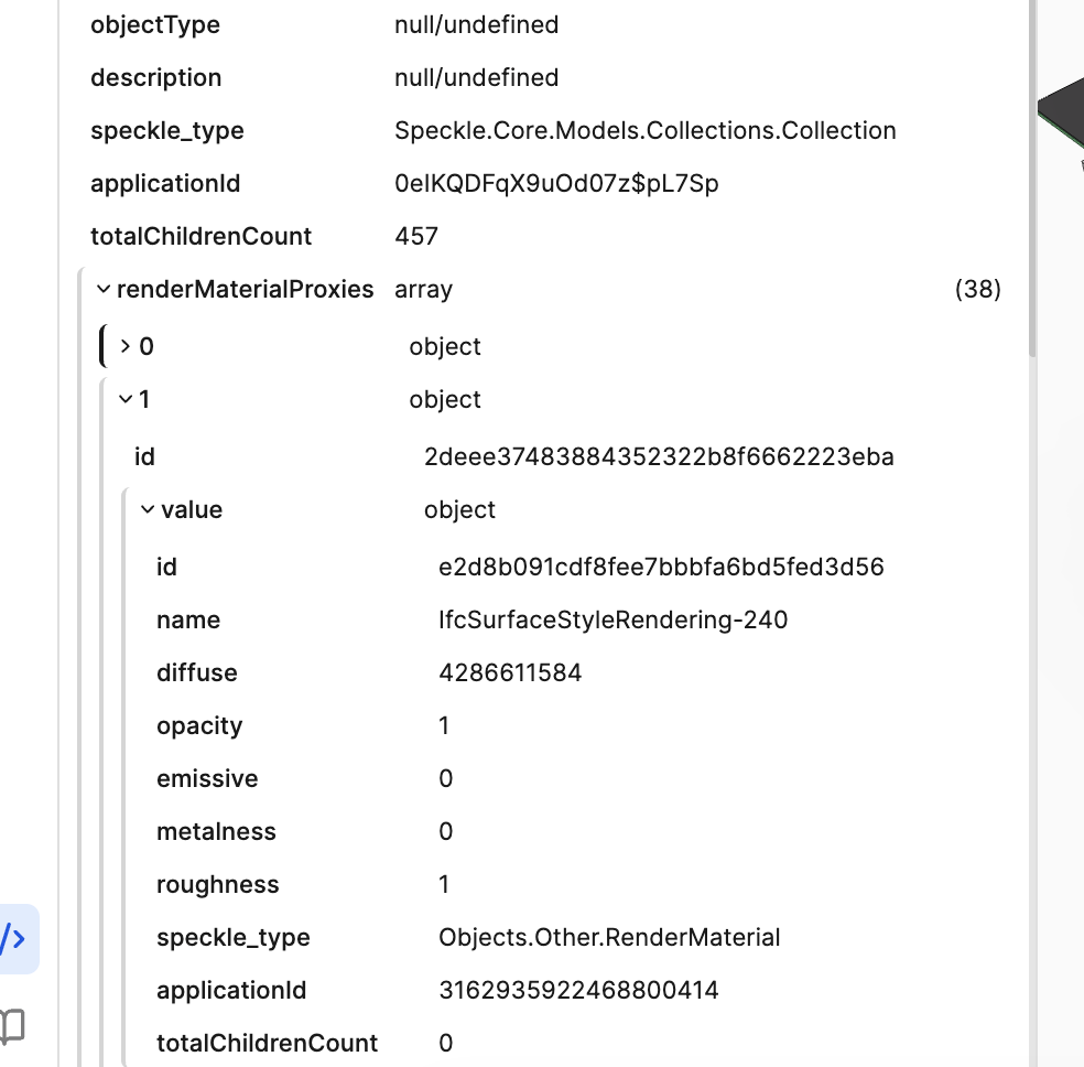

  • Issue: The ifc converter creates render materials. These names used to have the material of an element (IfcMaterial:Name). Recently this has changed to be a combination of the class of the rendering specifications IfcSurfaceRendering and a number. The number appears to not have a connection to the IFC Specs (at least we couldn’t identify any).
We are not sure when tis change occurred. The issue is that there seems no material information accessible anywhere anymore.

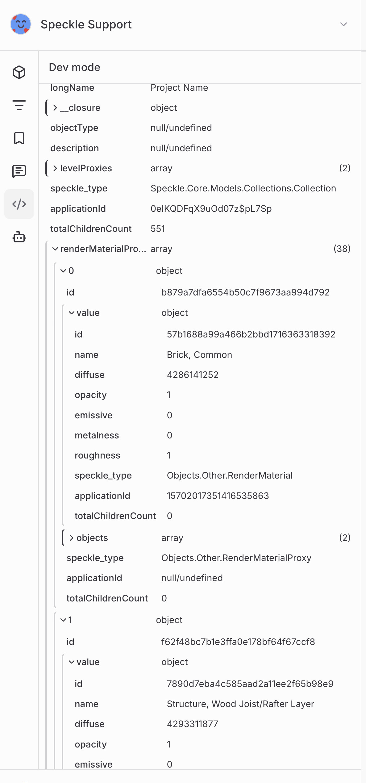

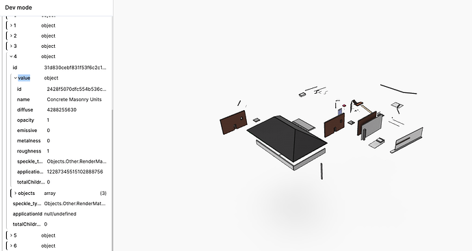

For reference the file you shared presents Materials in the renderMaterialProxies name field on app.speckle.systems
projects/8f9b7d436a/models/2dd2da42db@1f9436fa27
I invited you to our speckle project.
here you can se an old exmple
